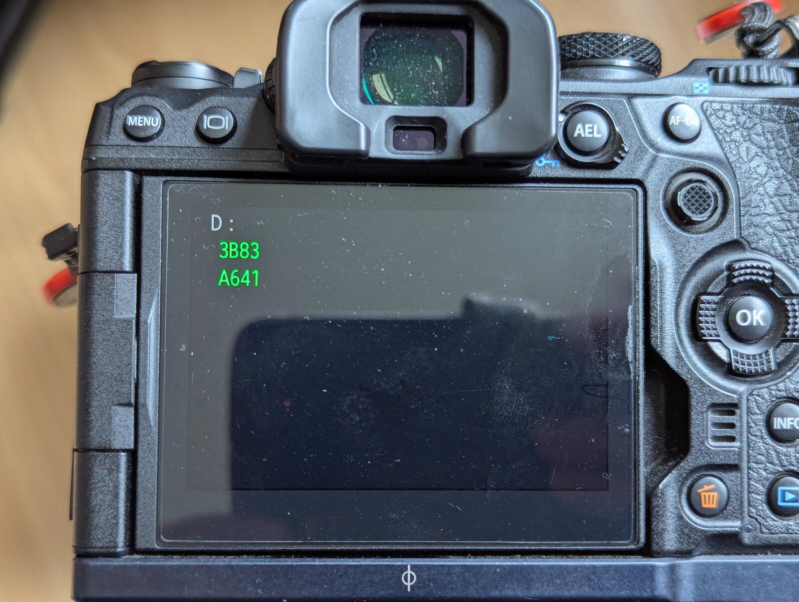

          It might be worth going into the hidden service menu where the shutter count is recorded and checking page 4 which is “damage codes”, a diagnostic used by OM support. It won’t tell you much but if there are some hexadecimal numbers recorded there it means the camera detected a fault otherwise it just shows “D:”. Mine looked like this, it is not possible to know what these numbers mean as the codes and meanings aren’t fully listed anywhere.

          In my case, the OM-1 Mk2 problem didn’t persist and I just recorded this image and pressed OK to clear these. Don’t do that if you have a persistent problem and intend to send it for service!
