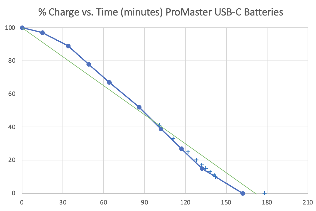

              I got one of this to try as I will need a minimum of 3 blocks for my Bromo trip
              Ulanzi offers a wide stock of the Best Camera Accessories ranging from camera Tripods, camera cages, camera stabilizers and other accessories at the best prices.
              So far, it's been charging and displaying correctly the %. Only catch, I was advised by the seller not to use the cradle to charge but to use the USB C port on the battery.
