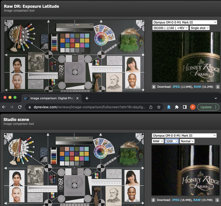

    Finally, if you want to see the effect of ISO invariance, you can do this using the DP Review studio test scene (links below). Here's an example of shooting the same scene with the EM1.3. One at ISO 3200, the other at ISO 200 and boosted four stops:
    Click image for larger version  Name:	Untitled.png Views:	0 Size:	764.9 KB ID:	909088
    It's close, but not perfectly ISO invariant - the ISO 3200 is a little better (but not really much).

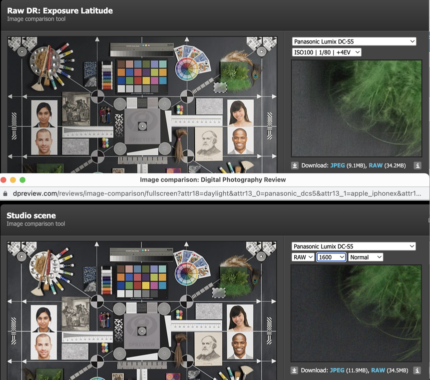

    Here's the corresponding example with the Panasonic S5:
    Click image for larger version  Name:	Untitled.png Views:	0 Size:	755.3 KB ID:	909089
    You'll see that the two shots now have very similar noise.

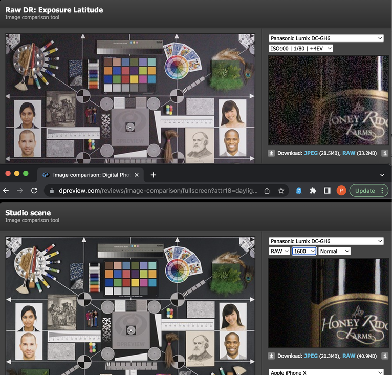

    If you want to see a camera that has poor ISO invariance, then look at the Panasonic GH6. These two shots are at the same exposure, but one is at ISO 100 and pushed four stops. The other is at ISO 1600 but not pushed at all. The pushed image has way more noise. The noise on the ISO 1600 shot is competitive though so for BIF etc where you're just needing a higher ISO, it will perform much the same as an Olympus camera; but for landscape where you need to push shadows, it'll be much worse.
    Click image for larger version  Name:	Untitled.png Views:	0 Size:	757.0 KB ID:	909125

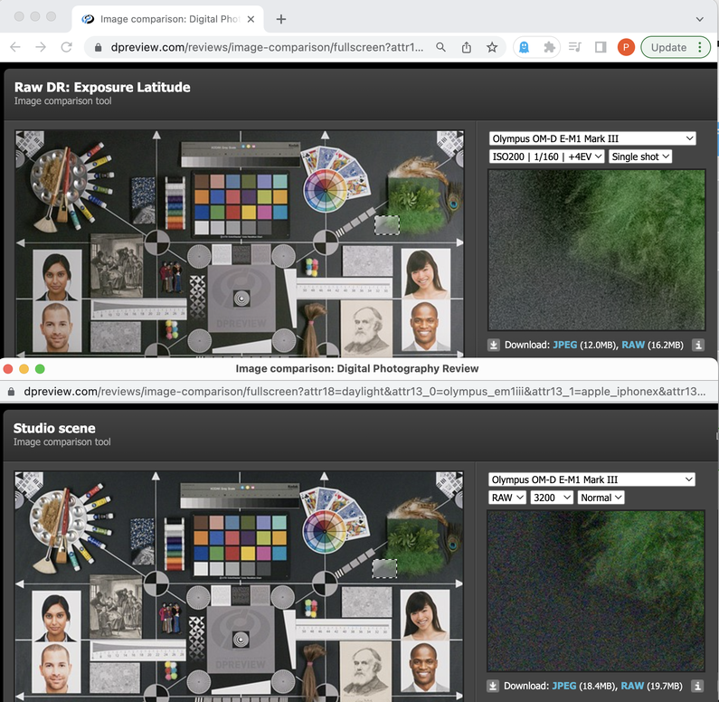

      For comparison, here's the Olympus EM1.3 with the same bit of the image enlarged.

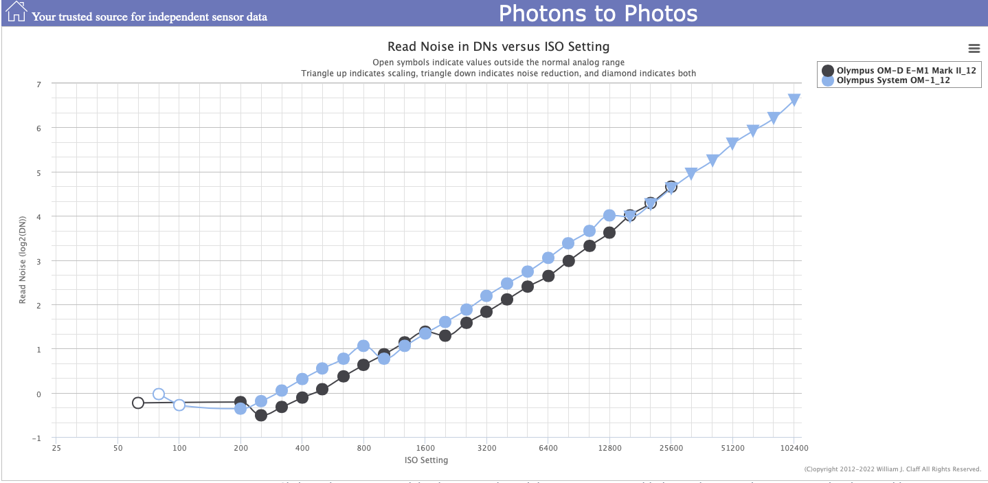

      To follow up in Mike point about ampler steps. The infamous photosonphotos web site shows that the em1-ii has two step points at 200 and 1600 iso;
Name:	Screenshot 2023-01-16 at 07.17.07.png
      So academically this suggests that for the em1-ii iso 320 MIGHT give better response than 200. While the OM-1 has these points set to 800 and 12,800.
      Second point to make is that there is a lot more noise processing being done now so the apparent effects of using higher iso or underexposing are being much reduced. This means I shoot in manual and auto iso instead of the shutter priority that I would have done on older cameras.
      The noise reduction process's we all use totally changes the dynamic range we see in reality compared to the graph above an means we are getting acceptable images at much higher iso's that we used to.
      It is therefore easy to to get lulled into the thinking that iso does not matter much.In reality shooting lower iso is way better as long as shutter speed high enough to avoid blurring.
