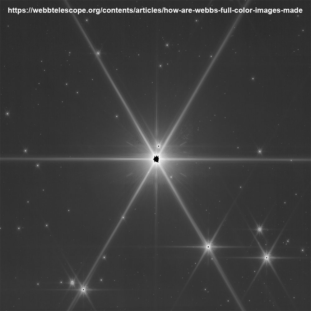

    The James Webb Telescope does them well, too - presumably because of its multiple mirrors:
Name:	Webb Telescope.jpg
    Mike

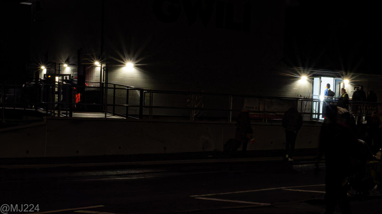

      Panasonic 8-18 & 15.
        Nothing amazing, but six for the price of one...
