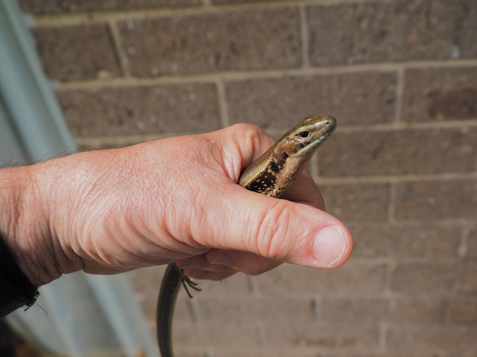

          While I only have 2GB memory in my video card & can't use AI Noise Reduction, I have noticed the highlight recovery seems to be much better than it used to be now.
          Here is an original JPEG (E-M1) followed by a RAW edited (& cropped) in OM Workspace, pulling back the Highlight to -6. In the past (not sure how far back now) it would just go grey. Maybe not the best example, but I'd be interested to know how others find it.
          BTW, this was a Water Skink that came inside & being relocated outside so it didn't become a dog chew toy.

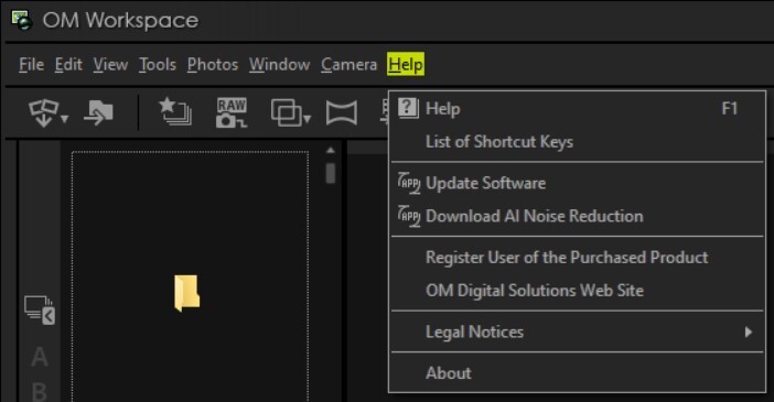

              I am tearing my hair out trying to get Workspace 2.00 to work as it should. I uninstalled it and have now reinstalled it after numerous attempts. However there seems to be some things which are not working properly. I can't find AI NR anywhere. I assume it should be in the Edit menu but there is no noise reduction option available. I tried downloading AI Noise Reduction again but it said it was already installed. Also I watched a Robin Wrong video on Workspace and in the White balance menu he used a picker to set the grey point. That is not an option in my Edit menu. I think I should delete every file to do with Workspace and start again but I don't know how to do it. Any suggestions?
              Ron
              • #25
                Ron
                AI Noise Reduction has to be separately downloaded from the Help dropdown.
Name:	AI Noise Reduction downlown.jpg
                • Olybirder
                  Olybirder commented
                  I have tried that but it tells me that Ai Noise Reduction is already installed.
                  Ron
