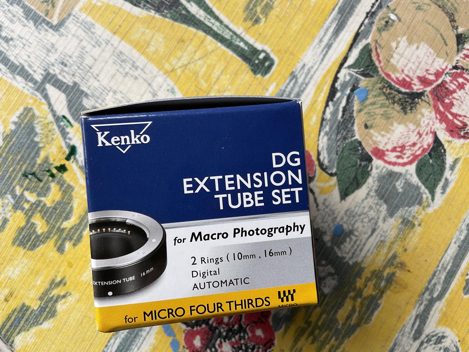

    My daughter has an E-M1 Mark 1 and the 12-50 power zoom. She has borrowed my 60mm macro and has enjoyed using it. I don't think she can justify buying a 60, so I was thinking of getting her some extension tubes or a close-up lens - I haven't used the latter since my film days. I wonder what those who know better would recommend? She also has a ZD 12-60 that she uses for shooting video.
    Click image for larger version  Name:	IMG_0084.jpg Views:	0 Size:	314.1 KB ID:	1026825
    Ian, I have some that were recommended on here a while ago. Kenko DG extension set 2 rings dedicated micro four thirds. They are in mint condition and free to you!
    I cant post them until next week though.
    dave
        dave
        Wow, Dave - that's amazing, thank you. I'm sure she will love these. I am still interested to know what people think of the clip-on-the-front option, though maybe I should have been more clear, I was thiniing about the Raynox clip-on lens that has been well reviewed.

          Just beware that not all macro extensions are created the same. I had to return a few just to get a set that works and still not all lenses work flawlessly. It's something to do with the locking pin.

                Just bear in mind that with extension tubes you lose light which is not the case with front of lens filters like the Raynox.
