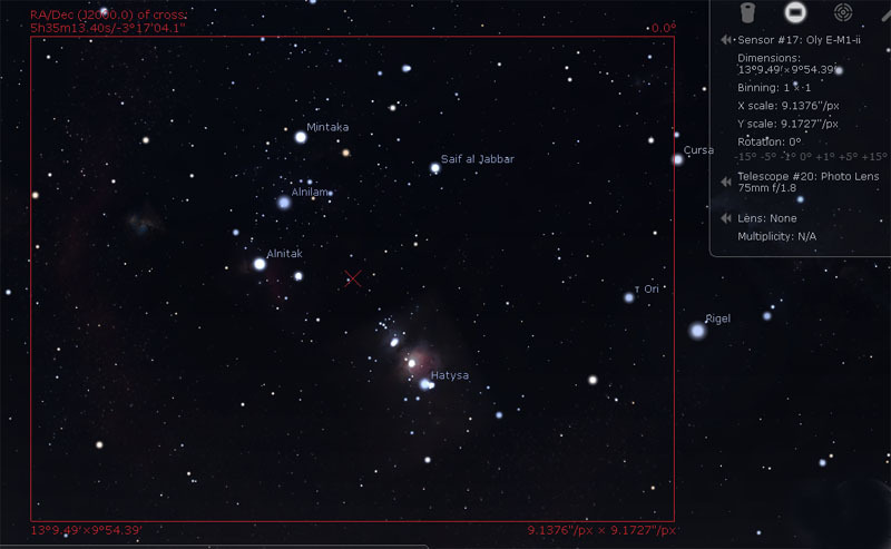

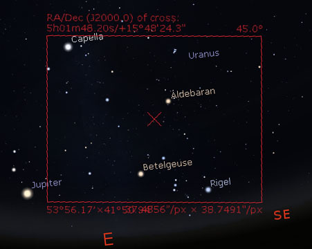

        To give an idea of what to expect, I used Stellarium to show the area covered by a 17mm lens on an Olympus (MFT) camera:
        Click image for larger version  Name:	Night Sky_17mmFOV.jpg Views:	0 Size:	55.0 KB ID:	1035661
        For comparison, this is shows the FOV for a 75mm lens on MFT, with Orion as the subject:
Name:	Night Sky_75mmFOV.jpg
        Mike
