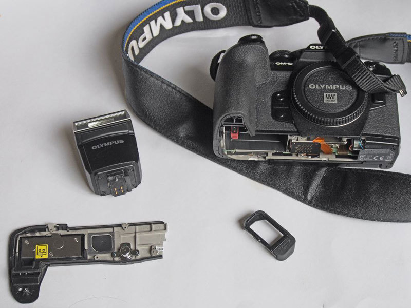

      Anything can break, if provoked hard enough. This photo shows my first E-M1 Mk.ii after I fell when it was hung round my neck with a monopod attached.
      Unfortunately, the monopod dug into the ground and acted as a lever to wrench off the base-plate. Notice that it didn't break at the tripod bush itself. Also, even on the model, the base appears to be plastic.

        That's an interesting photo. It seems that the tripod bush mounting arrangement is the same as on the exploded illustration of the EM5.3 - just a lightweight couple of screws holding it to the base plate (and a plastic base plate at that). I'm now quite concerned about putting any force onto it at all!

      In conjunction with Mike's picture above.
      The external plate is metal, I'm pretty sure....EMP.
      The tripod bush is metal and flanged in three positions on the inside....TB
      The base is plastic.
      The TB is attached through the EMP with three screws into the TB flanges, thus clamping the EMP, to form a sub-assembly....TBSA.
      This TBSA is then attached to the plastic base from the outside with three screws.
      The TBSA is quite wide and spreads the load over the plastic base.
      Notice how in Mike's photo the TBSA did not fail.......the accident tore the base off first.
      All is IMVHO

        Doesn't inspire me with confidence. The essential point is that the entire load on the tripod bush is carried by a thin plastic base plate. I would have expected it to be held to the main frame of the camera.
      surely if it was anchored to the main frame it would result in a lot more damage : I'm assuming they are built this way as a possible fail safe a £100 repair as opposed to a £700 repair
