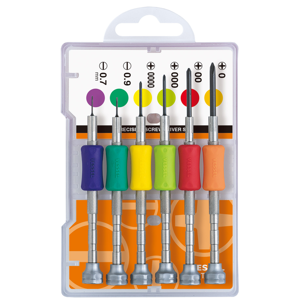

                  The size for the main screws is "0" but the small screws for the connection plate (camera side) is "00".
                  I'm using VESSEL No. TD-56S Precision Screwdrivers Set. https://vessel.co.jp/english/product/screwdriver/251389

                  • Box Brownie
                    Box Brownie commented
                    Many thanks for the pointer
                    I have found the TD-56S on Amazon so will order that set to check my Mc14 screws and the set will be a good addition to my toolkit
                    Edit ~ set ordered, should be here tomorrow......................will see if any screws are indeed coming a tad loose???

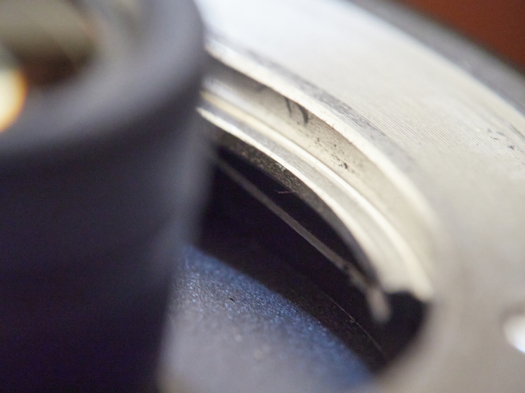

                        On the mechanical side of it, the three leaf spings on lens mount side are there to keep a firm mount of the lens & I assume there may be a slight amount of movement possible if flexed hard enough. With these springs the mounting feels firm, but if they (or one) has collapsed then it might be physically possible to notice a less firm fit.

                          Thanks for the added insights.
                          If one or more of those springs has lost its tension, hopefully the repair technician will be their (usual) diligent selves and determine the cause, if there?
                          Furthermore more I do hope that based on my diagnosis I will send with the item they will initially test and replicate the problem and thus know what needs replacing/repairing?
