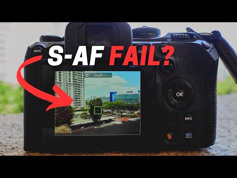

          I see Robin Wong now has an OM-1 and is not happy with the S-AF focus performance.
          He says he’s tried a larger focus point group and still had issues. He’s usually pretty enthusiastic about the OMDS cameras - it feels like something is going on to set him off making this video. I mostly use C-AF so haven’t experienced problems with this outside of some early tests.
          • Ross the fiddler
            Ross the fiddler commented
            I just see that he's having a big negative gripe.
            I was going to add a comment & realised I already did with his replies.
            Here is my feeling & the new reply comment to Robin that I deleted just now.
            @Robin Wong "Again, the above examples of S-AF are ridiculous. You didn't go out & get new subjects but still regurgitation the same old ones. Come on! You are spreading incorrect advice here. You call yourself a professional, but you are not displaying that at all here. Those examples have next to no detail in them, but the times you do actually hit on some detail it focus locks. Go out & focus on some sensible subjects & don't use Single AF Target unless needing it for situations where it is necessary to pinpoint AF, but the subject must have some detail in it in that Single AF Target area. Do use the Small (9 group) AF Target or larger, depending on the subject. This is NOT the same as previous models because of its stacked sensor with quad photosites per pixel (go look up all the technical detail on it to understand it).
            I have to ask, did the donor of the camera expect you just pull this camera apart, because I wonder what they think of your video presentation?"

            Yes he's having a downer on OM at the moment. But the fact remains that the OM1 is doing SAF differently to all previous Olympus cameras and in some circumstances it's giving focus confirmation when it is out of focus. That's a cardinal sin in my opinion.
