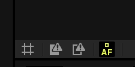

    OM Workspace actually shows where the focus target was if viewing a raw file.
    Its the button marked AF on the bottom bar of the window.

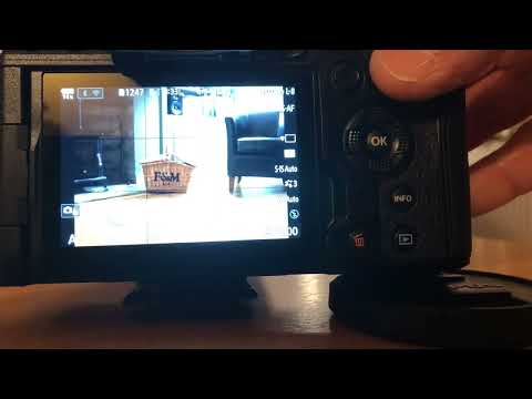

                This is becoming a pretty common issue now. Here's a video of the problem:
                It keeps doing this until the power is cycled:

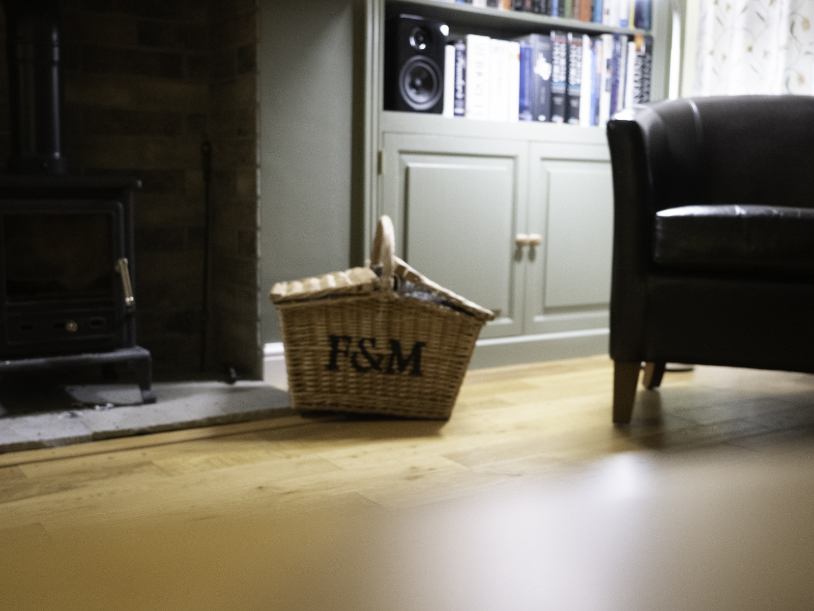

                It seems to be a time/number of shots issue. The more shots you take, the more likely it will happen. Only a power cycle gets it back to working again.
                  I suspect it's probably not a focus issue now. For two reasons:
                  1) The focus looks good on the screen before I press the shutter
                  2) Reviewing the photo after on the PC, it's blurred everywhere, nothing's in focus
                  So, I'm suspecting a problem with the IBIS.
