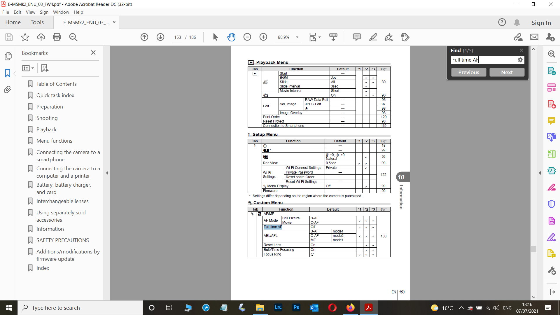

      Thanks for your reply. Yes, the Full-time AF is on my EM5 mii and has proved very useful. As for battery life, I just turned the camera off when not using and carry a spare.
    John, your are right. The EM5 mk2 has a Full Time AF mode, but I cannot see it on the Em1 mk3..
    I have tried it on the EM5, but can't get it to work, but there quite a few reasons in the manual that say that it won't work with certain settings
      There is a very good setup tutorial here.
      Here are the menu changes I've made to my Olympus OMD EM1 MKIII for use in event and portrait photography. Feel free to ask questions below and I'll do my be...
      I have not found a way to make the EM1mk3 use autofocus like the EM5.
