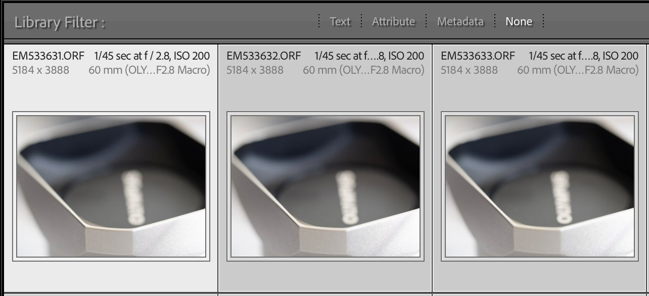

      For info, here is a quick comparison of some focus stacking PP tools. They are useful when the in-camera stacking fails. In this example, I took a shot of the 12mm f2 lens from close in using the 60mm macro. I needed to take 19 shots with a focus step of 10 to get the entire depth of focus needed. The in-camera stacking only goes to 9 shots, so could not do the range needed for this.
      Here is a preview of the first few shots in the stack to give you an idea of the sequence:

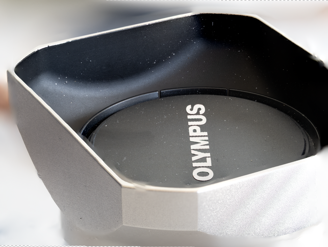

      1) Photoshop
      Not a great result - terrible artifacts on the front of the lens hood! On easier stacks it works fine though and it will handle ORFs directly. But it's quite slow to do the stacking.

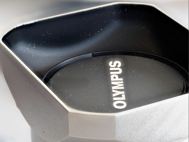

      2) Zerene
      Much better result. It's also quite fast - but it needs TIFF or JPG files. No support for ORF. It's also $189 for a one-time licence of the "pro" version, so not exactly cheap.

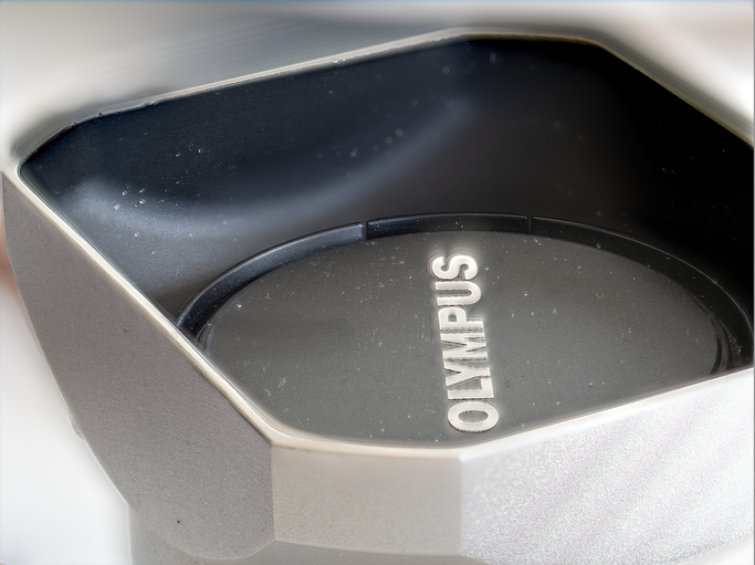

      3) Helicon
      Not so good either. Lots of halo effect. Doesn't work with ORFs either. A bit cheaper than Zerene at £29/year or £111 one-off.

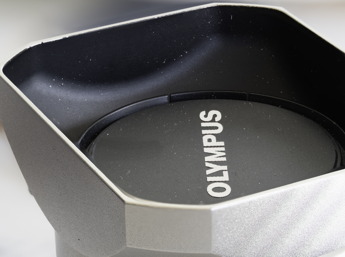

      4) Hugin
      Although Hugin is best known as a stitching tool, it will do focus stacking too - but you have to use command-line tools.
      The result isn't too good though. It's free, but on this evidence it's not worth it!!

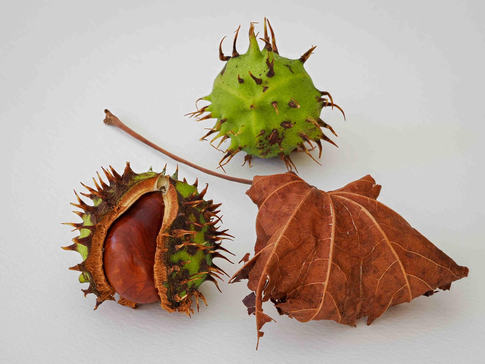

        I got the 60mm macro at the Photography show, but here is a focus stack with the 12-100mm 10 stacked at f8 as per Wanderer. The 60mm Macro
        Click image for larger version  Name:	Conker arrangment.jpg Views:	0 Size:	222.0 KB ID:	893624
Name:	Conker arrangment-2.jpg
        Last edited by sapper; 29 September 2022, 03:03 PM. Reason: Second with 60mm Macro. Different angle.

          I think so, I will try it again with the 12-100, which I prefer for this size objects.

          I think focus stacking is useful in two cases:
          - To extend the DOF to be bigger than can be achieved even at a very small aperture (e.g. f16)
          - To isolate a subject from its background by using a wide aperture yet stacking to get it all in focus without reducing background blur
          The former is of most use for small subjects close up, esp if the background is plain. The latter is useful for larger subjects with a messy background. For medium-sized subjects on a plain background, then I don't think it's necessary since an aperture of (say) f8 or f11 will probably get it all in focus on one shot. I think this is true for your leaves and conker shot.
          My original photos here all fall into the second category and I shot them wide open with the 12-40.
        • sapper
          sapper commented
          F8 does not cover the distance from front to back on this shot. I will post it here.

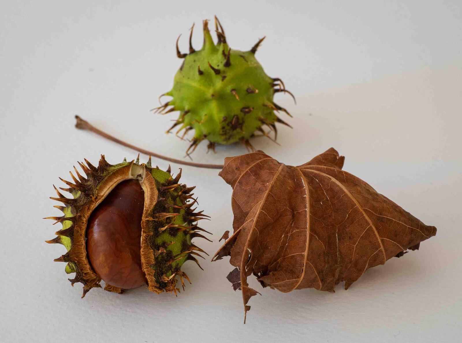

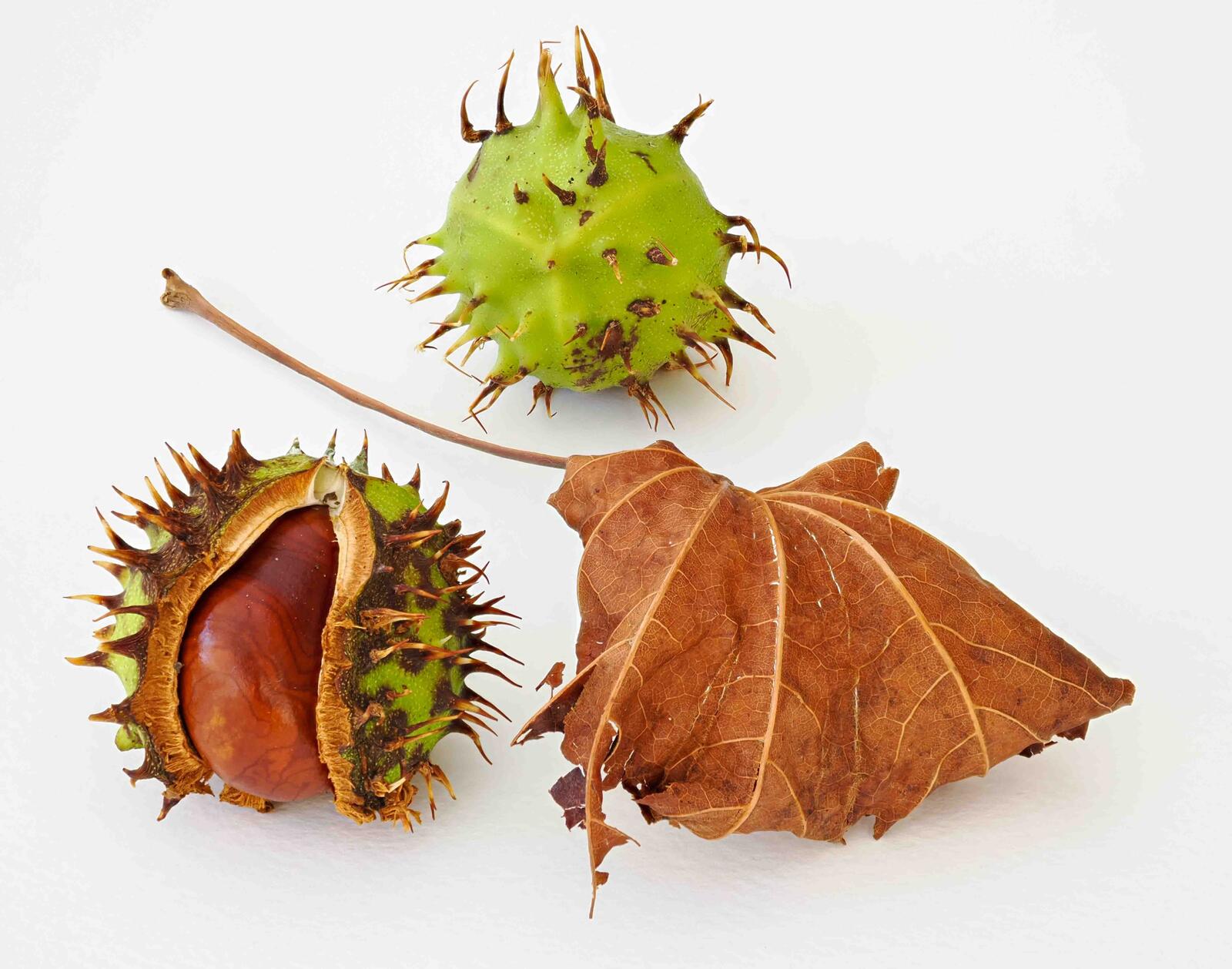

        Here's another test - this time with something that will stack in-camera. All at full size (after a bit of cropping).
        Summary - all are OK, except for Hugin, which is a mess.
        1) In camera
        2) Photoshop
        3) Zerene
        4) Helicon
        5) Hugin
          Here is one at f4 with the 120-100mm which I prefer for this distance.

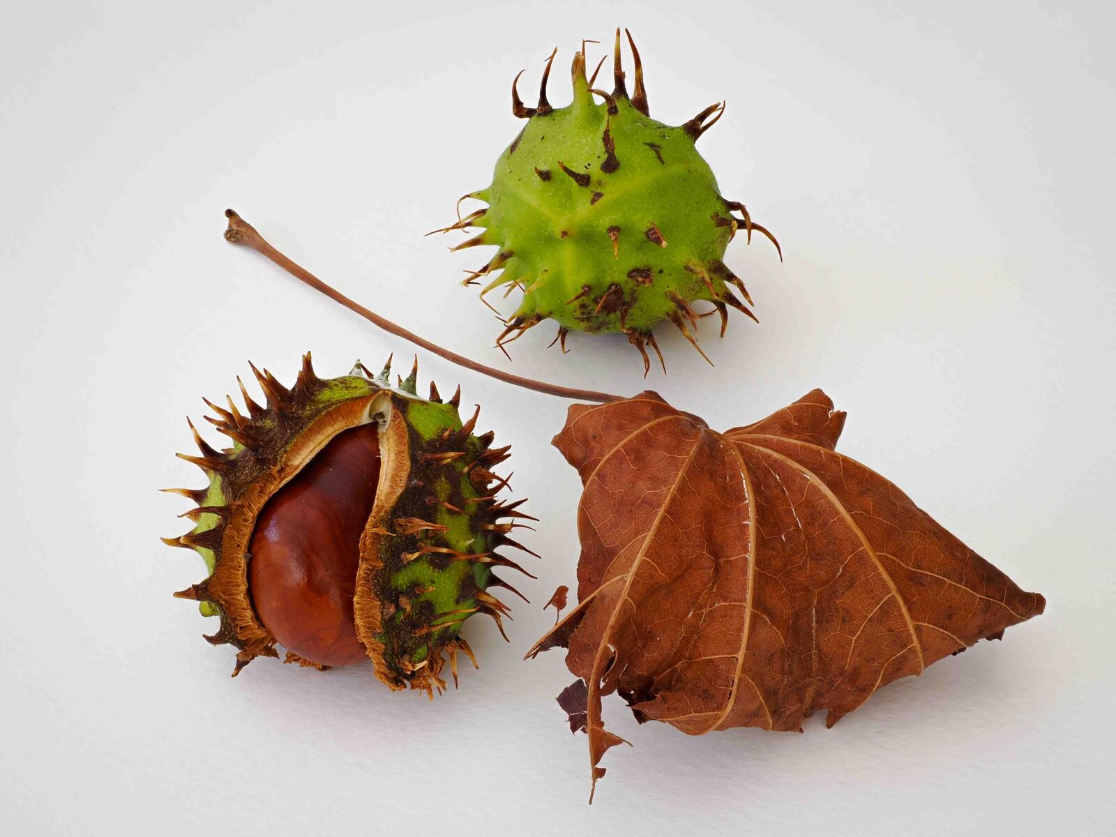

            Taken at f8 in. response to Paul.

              Yeah - you're right (why should I ever have doubted it!!). I thought at first glance that it was photographed from above onto a flat surface - but I can see now that it isn't!
