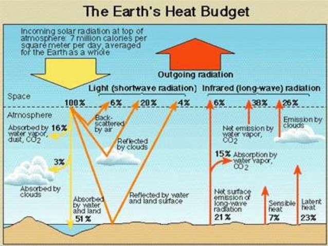

                          Originally posted by sapper View Post
                          ................. When we take heat from the earth, is it replaced by the suns heat?
                          Overall, the Earth is warmed by radiant heat from the sun. This energy is absorbed and raises the temperature of the earth, which then starts to radiate heat away into space until an equilibrium is reached. If there were no atmosphere, this equilibrium would be reached when the earth was at a chilly minus16°C. (average)
                          Fortunately, we do have an atmosphere and some of the gases, such as CO2 and water vapour, absorb some of the heat re-radiated from the earth and prevent it from being lost into space. This process raises the overall temperature to something we can live in.
                          When we burn fossil fuels, we release lots more CO2 into the atmosphere, which then absorbs more of the re-radiated heat and so the overall temperature of the earth rises. On the other hand, if we use heat pumps, we only move some heat from one place on the earth to another (our homes). This has no effect on the 'total' amount of heat stored by the earth and therefore has no effect on the global temperature..
                          The various heat flows that control the temperature at which the earth reaches equilibrium can be shown in a diagram. There are a great many factors, in addition to the effect of greenhouse gases, such as cloud cover, which lead to a complex scientific problem that makes it difficult to predict exactly what will happen to climate in the future. The evidence so far indicates that CO2 is, however, a major factor.
                          Mike
                          Mike

                            Glad you found my comment helpful. You need to think of the earth and its atmosphere as what we scientists call a 'closed system'. It receives energy from the sun and it radiates energy into space. The balance between these two determines the mean temperature of the earth. If we move heat about, within the closed system, it makes no difference to the overall balance.
