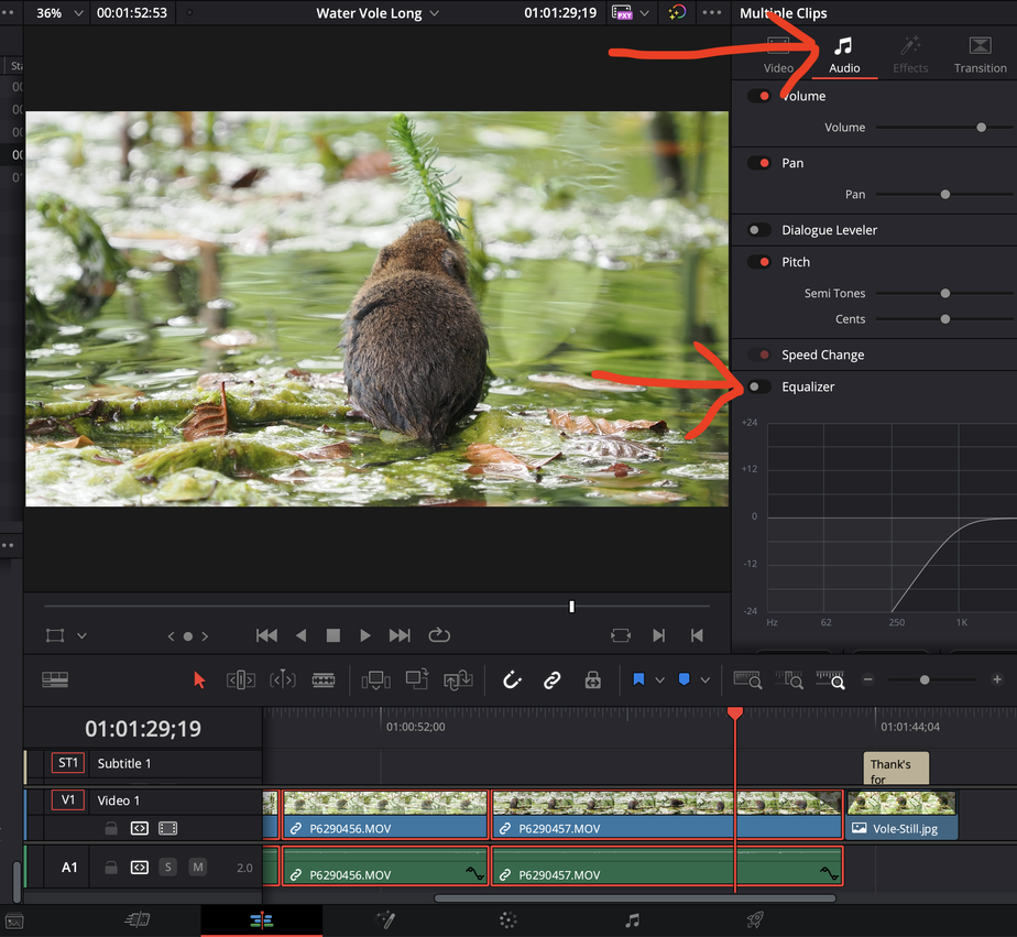

I do this in the video edit interface, select the video clip with the audio and click on the audio properties top right, then look for the Equalizer settings:

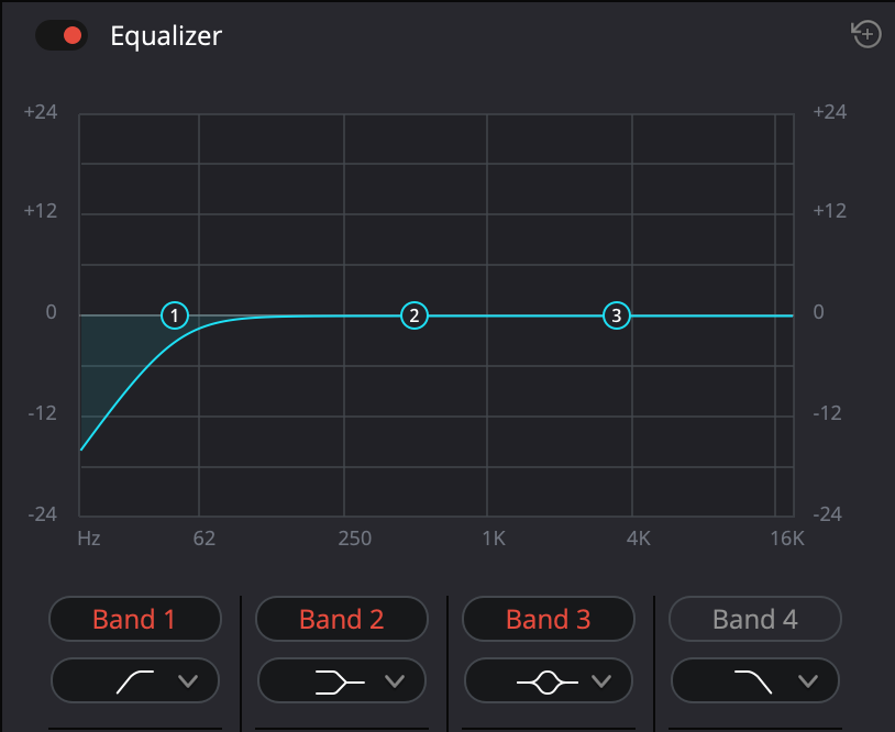

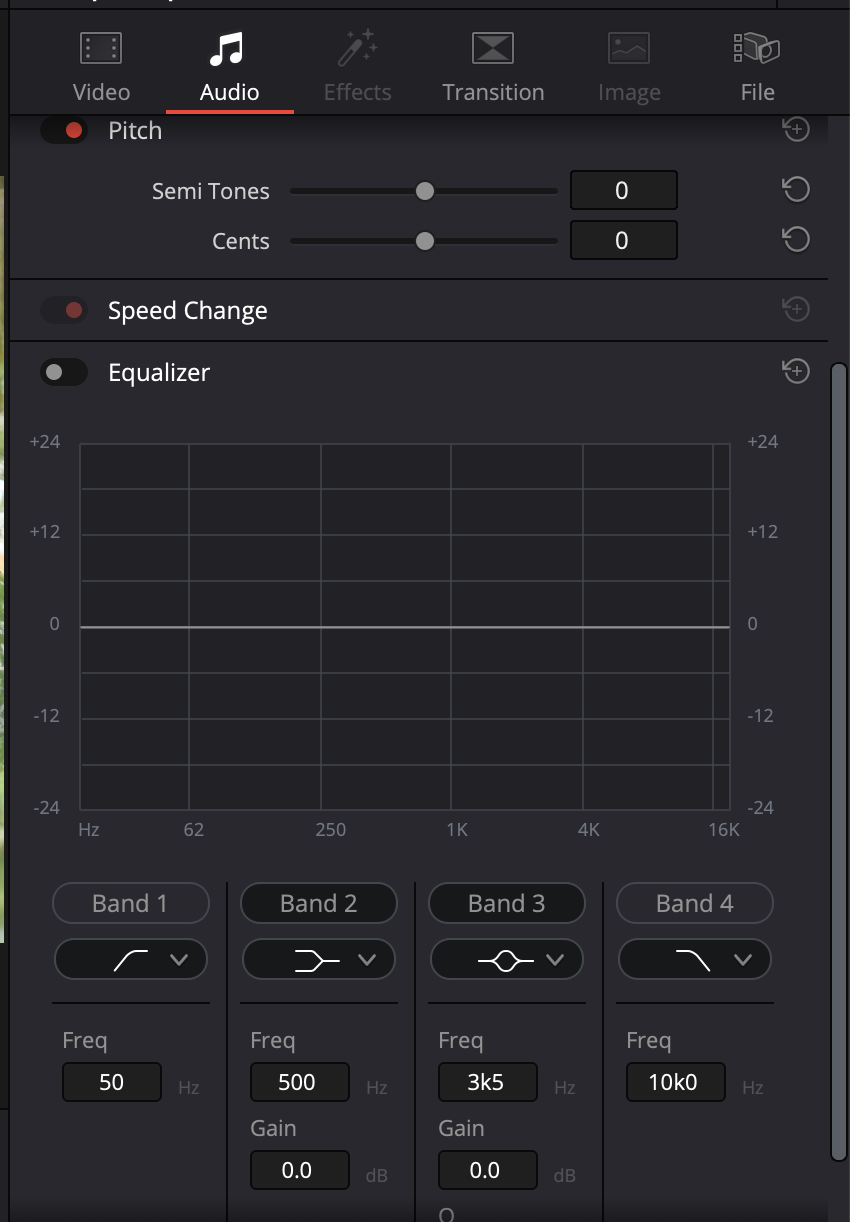

In the Equalizer what I do is set up a High Pass filter to take out frequencies mostly below about 500 hertz. Initially it looks like this, you need to toggle it on:

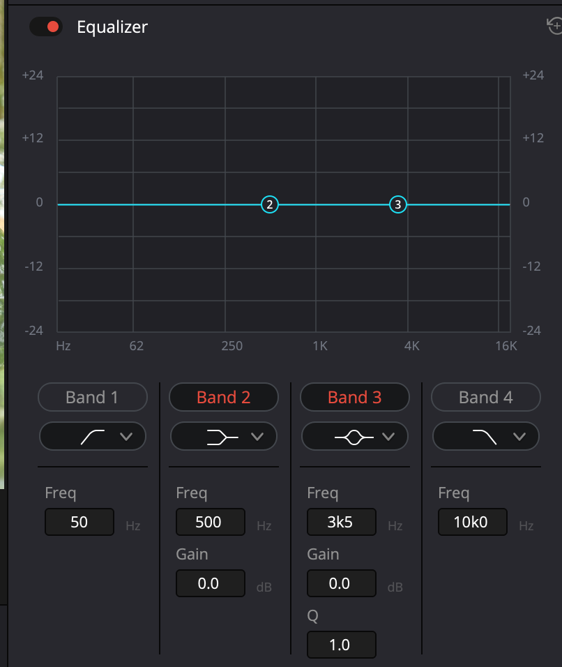

Then when turned on there are some frequency bands enabled, just bands 1 and 2:
I turn on Band 1 for the low frequency filtering - just click the "Band 1" button to enable it and you get this:

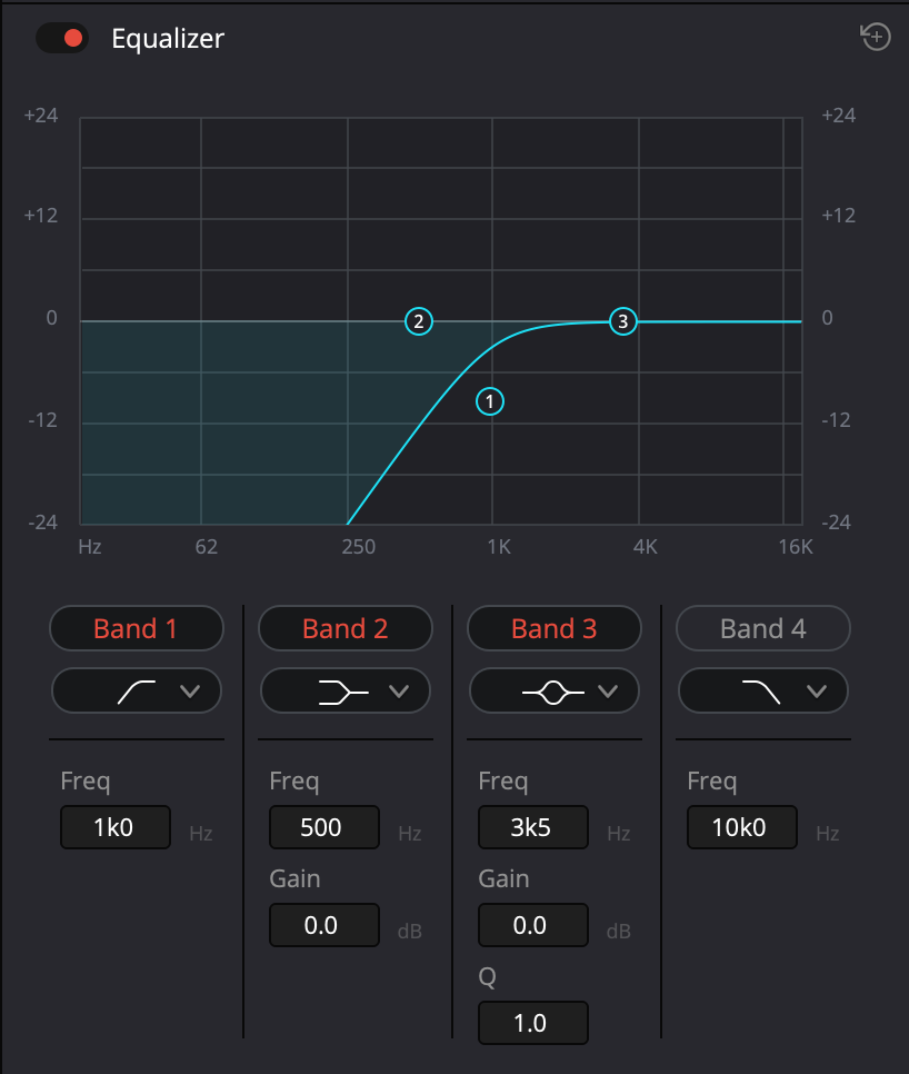

Then click on the circled number one and drag it to the right to get a low frequency filter curve between about 250 hertz and 1 kilohertz should be enough:
To hear the effect of it play the timeline video and toggle the Equalizer switch on / off and you can hear the difference (it doesn't lose your filter setup if turned on / off).
If the wind noise is quite strong you can try drag the band 1 filter marker further right to filter higher frequencies than 500hz but if it gets too aggressive I find it can affect the tonality of the audio.
