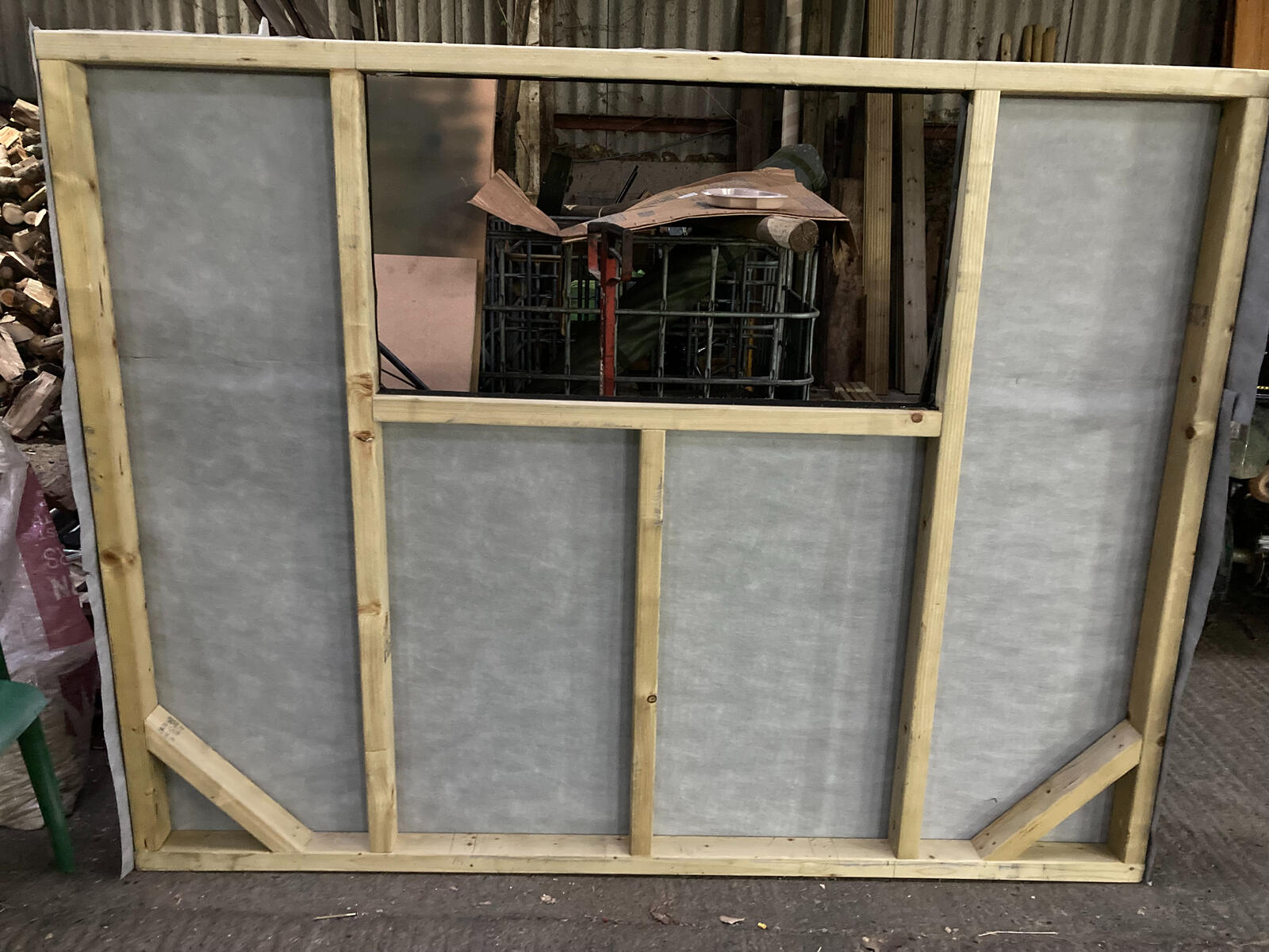

    Can you guess what it is part off?
    Edward
    A hide, perhaps?
      New hide I reckon
        Punch and Judy Show stall
          Shuttering for a concrete pour...??
            Well, it looks like a side, or even roof with skylight, of a garden shed ....... but I bet it isn't 😊😊
              Photography rain shelter for the coming UK autumn / winter
              Looking good 👍
                Well it looks like a timber frame with a fabric coveriing so I am going for a camouflaged bird hide. (Remember where you left it or you'll never find it again.) I like the Punch and Judy guess though.
                Ron

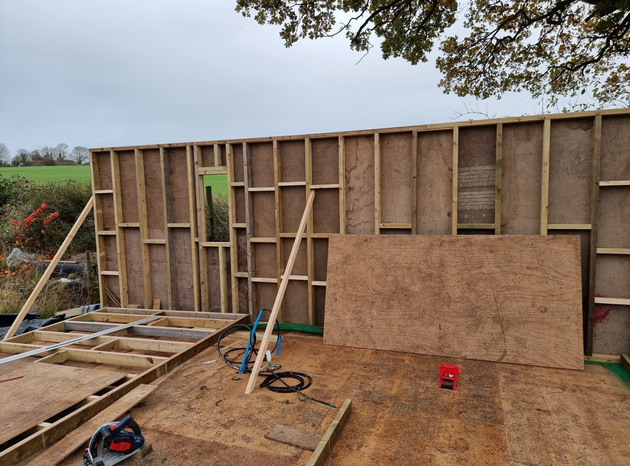

                  It is coming on, cant believe how much timber cost now. , two ends, roof, floor, door and glass to go , hot in the shed, Cider helps!

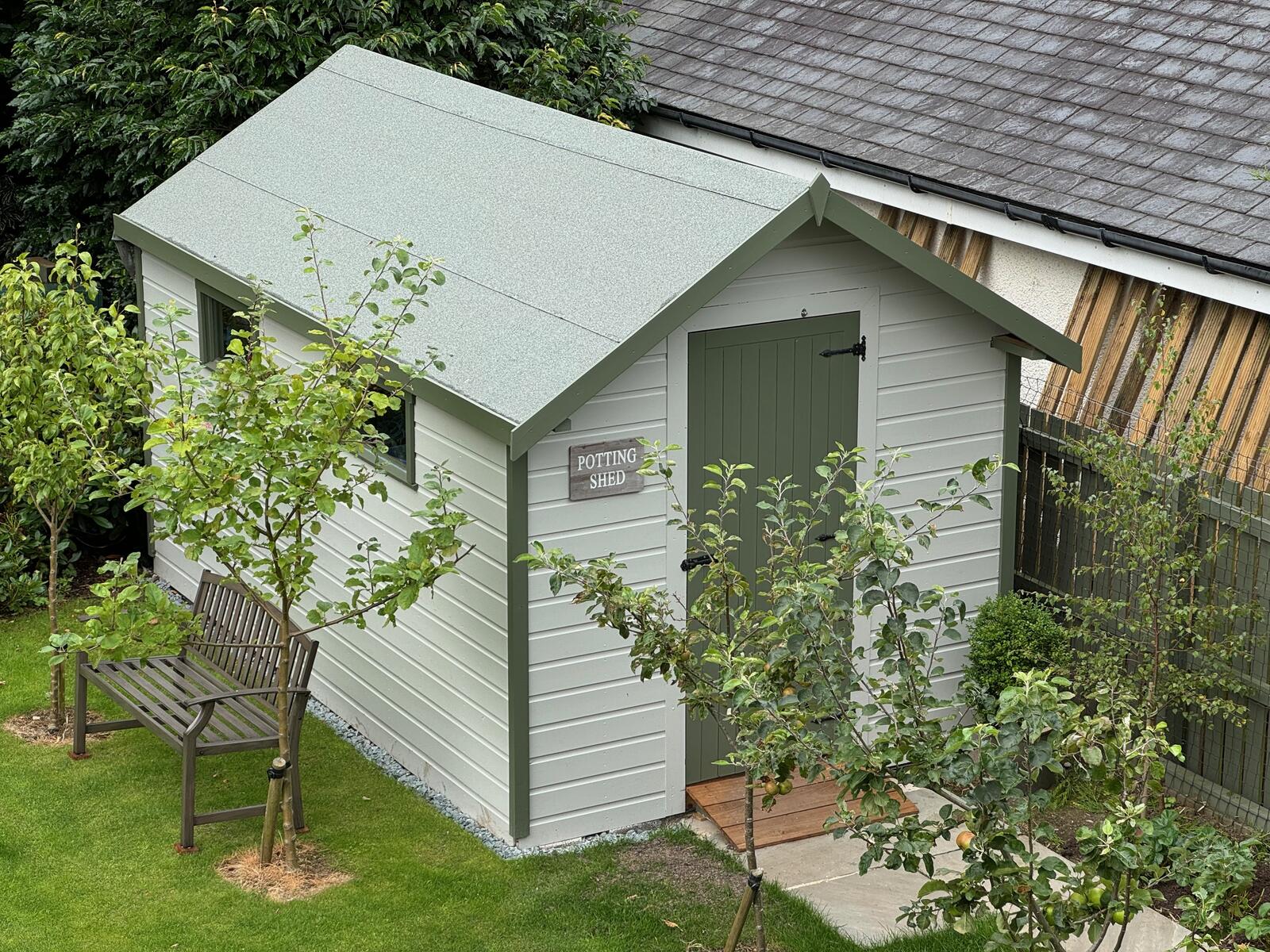

                    It looks impressive. Definitely better to build your own but wood is expensive you are right.
                      Finished building mine a few weeks ago.
                      https://www.gec.photography

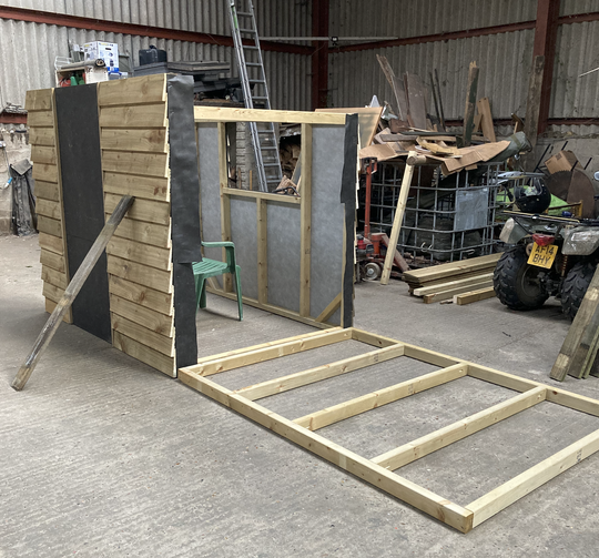

                      I saw it and I was thinking that is a side of a shed, but that would have been to obvious i though. Just a side note your cladding should not be straight on the membrane, it should have a batten first to allow for airflow behind the cladding.
                      Here the beginnings of my little shed
                      • rustyarrow
                        rustyarrow commented
                        I agree about the membrane but should be OK , few gaps in cladding here and there
                      • muh3
                        muh3 commented
                        Yes will be fine, it just lasts longer with the gap.
                      • rustyarrow
                        I am sure it will be OK, not as if I am living in it - then again! I will put some insulation under the floor and the roof but may leave the rest- undecided on that at this stage
                      Very impressive! Although I think they should really be called "Pottering sheds"
