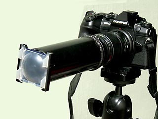

            If your slides are in standard mounts, they should fit in a 35 mm slide holder. I use a home made copier attached to my 60mm macro on my Olympus E-M1-ii. If you adjust the tube length to fill the frame vertically the 4:3 format makes a better match to your square slides than the 3:2 format of a 35 mm frame. With a 20MP sensor you should still get a 15MP image which should be enough to capture the detail of the slide.
Name:	slide copier Olympus.jpg
            Mike

              Best quality Blue Peter kitchen roll tube?
              How do you ensure consistent lighting with that?
            • MikeOxon
              MikeOxon commented
              Mine was actually made from black plastic drainpipe, with an empty filter ring glued to the camera end and an old hand-held slide viewer, cut down to just the holder part, glued to the outer end. I expect kitchen-roll tube would do the job. I use natural daylight (skylight) as the light source or you could use flash.
              It's very quick to work through a box of slides. I set the lens to MF and focus on the first slide, then use Aperture priority to keep a constant aperture of f/8. Also, turn 'off' the IS (stabilisation) because it cannot cope with the subject being attached to the camera and will wave about if the camera is moved. I use a remote release to avoid touching the camera. Before I made my own copier, I used a Canon 9900F flat bed scanner and found it tediously slow.
