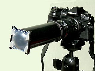

        I copied about 1600 slides last spring. I used a Kaiser slide copier attached to the OMD mkiii camera
        with the Oly 50mm macro and MMF-3 and an A5 sized light panel
        I found that letting the camera do all the hard work - eg focus, colour balance so that all I had to do was select the slide put it in the slide holder and adjust the slide holder such that it was in the centre of the image and then expose.

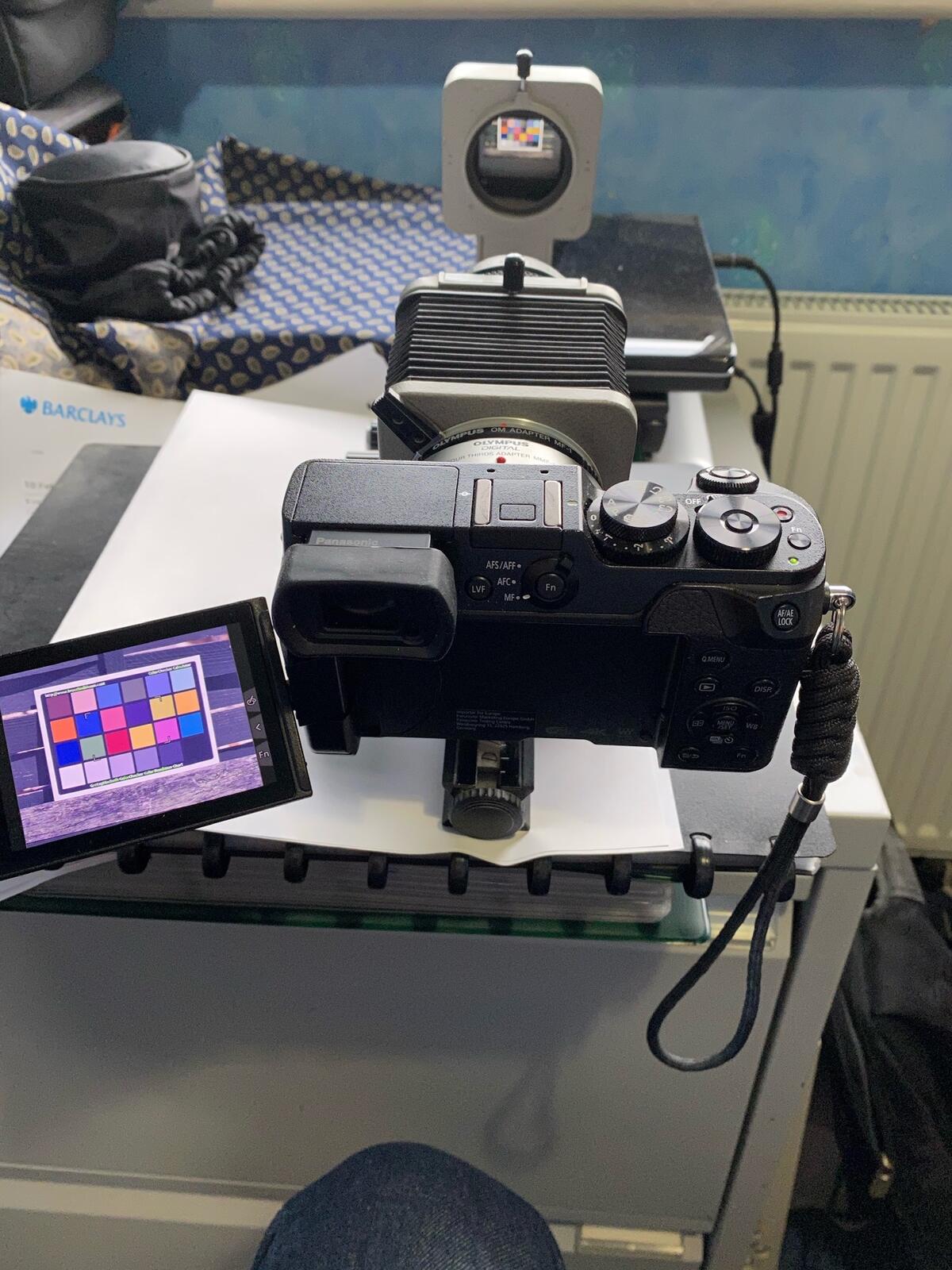

          I took the same sort of approach that DerekW used, although I had a Nikon ES-1 slide copier attachment hung on the front of a mZuiko 30mm f3.5 macro via a step down ring, on my M1iii. Lighting was with a small LED panel, daylight balanced (£20 on Amazon).
          The Nikon adapters (the ES-2 works as well) come up quite often second hand in the usual sorts of places (and in old-style camera shops, which is where I got mine) and even new you can often find special offers.
          The huge advantage of doing it like that is that you don’t need to set anything up very carefully (just check the slide carrier isn’t twisted out of kilter), and you can spend many happy hours snapping away while watching Netflix. Otherwise, many peoples arrangements need a lot of care and attention, and sometimes blackout, which would have made me lose the will to live.
          It is possible to use the 60mm f2.8 macro, but you need to customise some sort of extension tube for the ES-1 or -2 mount since they’re designed for use with one of the Nikon 50 - 60mm full frame macro lenses and you need to extend the slide-to-lens distance.
          I’ll post a quick snap of the setup shortly.
