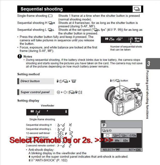

          You have followed the instructions in the Manual on page 61, have you? It's the Drive Mode with Remote selection at either '0' seconds or '2' seconds you need. Also, I assume you are not trying to use RC Mode in Menu 2 (page 80), because that is for remotely controlling flashes from the camera, not remotely controlling the camera.
Name:	E620 remote triggering.jpg
          Hope it works for you then.
