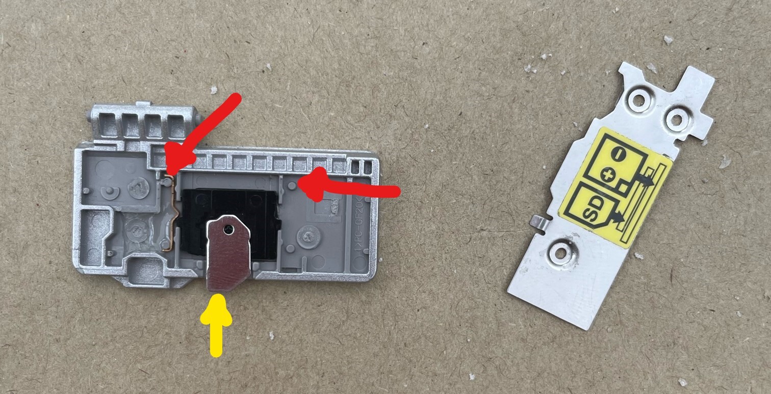

          DIY repair
          Should anyone happen across this on a search...
          The red arrows indicate where the brass/copper springs should sit. I lost one of mine I suspect before the last accident which is why the cover was a little loose.
          The yellow arrow indicates the orientation for the metal tab that secures the cover to the camera - first attempt I got it reversed and had to prise my repair apart and try again.
          With a toothpick, I added spots of (poundland) epoxy where the 3 holes in the metal plate align with the now broken plastic pins.
          Then put the metal cover on, applied 3 more dots of epoxy over the top and held it in place for 5 mins while it initially set, then waited overnight before fitting to the camera.
          The catch is very stiff and doesn't spring back, presumably because of the missing spring or perhaps the metal plate is lower than it was when supported with plastic pegs - but it feels fairly safe and closes very firmly.
