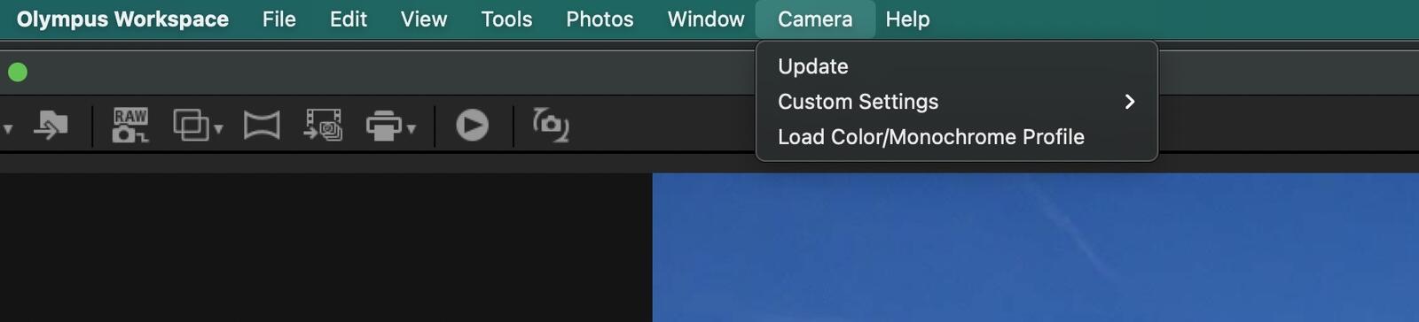

                You can get access to the updater from the Oly Workspace program.
                It's under the Camera top menu drop down - Custom Settings - Save / Load
Name:	Screenshot 2020-11-02 at 12.28.23.jpg
