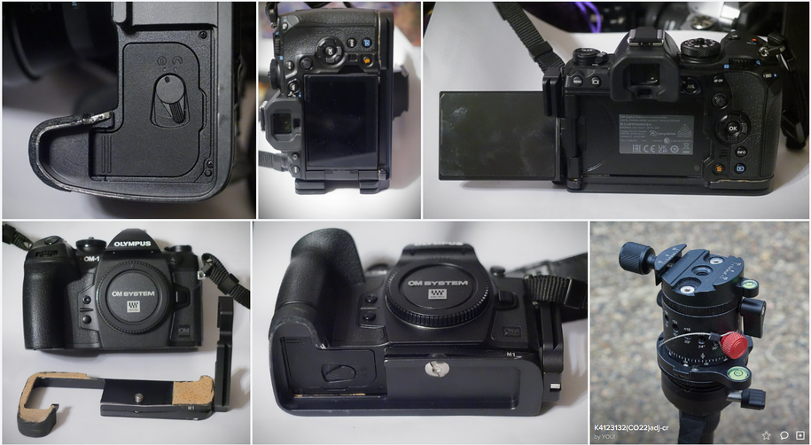

    Sadly, there aren't any 'cheap' versions for the OM-1 but hopefully someone will produce one now the Mk II OM-1 is out. I modified a cheap E-M-1 II L bracket base plate & it does me, but does require some removal (& addition) of material though.
    K9104942-ms by Ross, on Flickr
    More images here https://www.flickr.com/photos/ross-t...7699308362091/
      I sometimes use the one off my E-M1iii. It's not perfect but it's functional. The 3 legged thing is expensive and doesn't provide what I want; an extension of the grip for the right hand. Why hasn't an independent manufacturer produced one yet?!?!

        Think I showed somewhere that it's possible to mod those EM1mk2 L to fit the OM1. You need to file the tripod screw hole and the bit off the battery access.
        * Henry
        * Malaysia
        All my garbage so far.
          These are the photos I took. I added a bit of leather to the front grip with superglue (to give it some hardness), building it up to match the shape of the OM-1. I had to remove the lip across the front too (or was it the back?). Here's a screen shot of my photos in my Flickr album (as linked above).

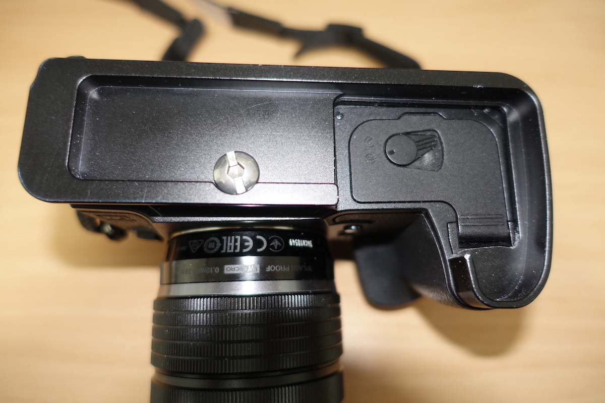

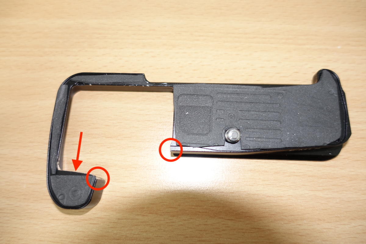

          I also modified the cheap plate that I had previously used on my E-M1 Mk III. The two photos show what I did. It was very easy; just needed a mini hacksaw and a file to remove ragged edges. I padded the plate with some sticky-back neoprene that I bought in Hobbycraft. The fit is a bit tatty but it does the job and the neoprene ensures that it stays secure and there is no risk of scratching.
          The circles show the two ends of the piece I had to cut out, and the arrow shows where I had to file the metal down a bit to let the battery door open fully.
