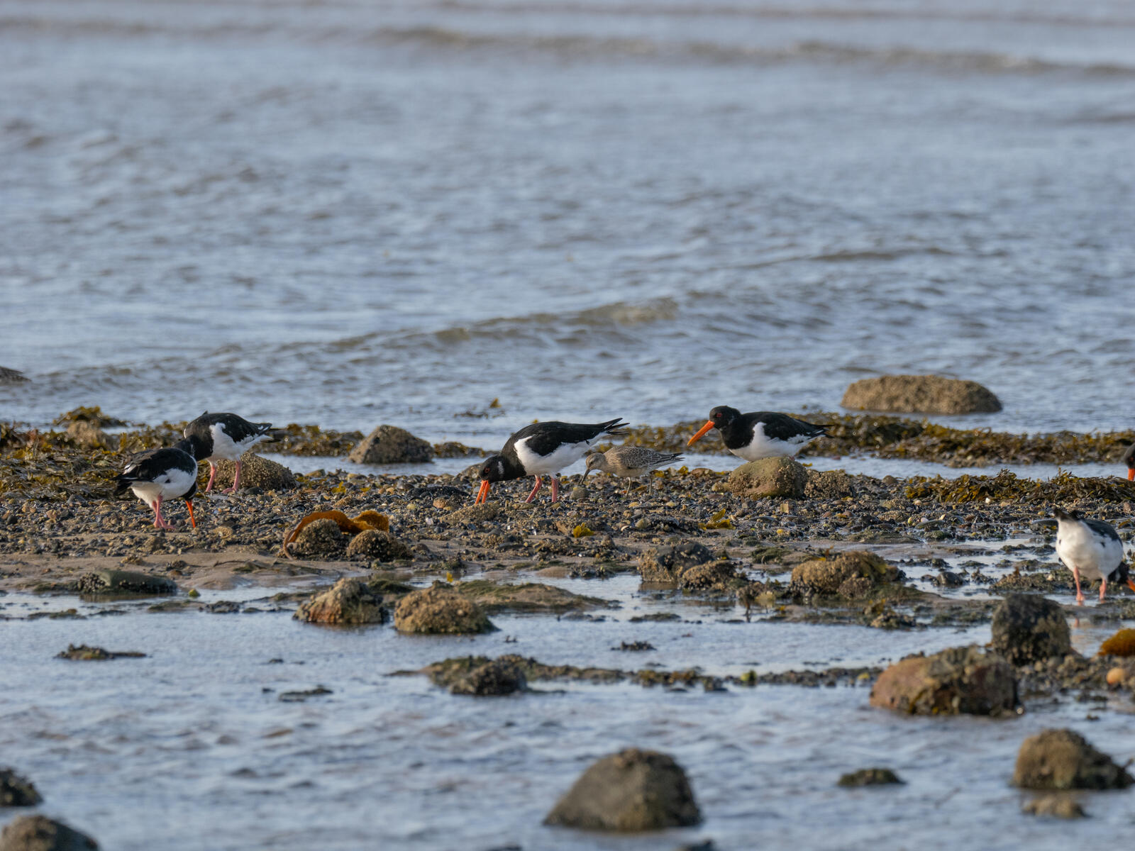

What AF settings would you use for this?
  • What AF settings would you use for this?
    The main subject is the little brown bird in the centre. What AF-C settings would you use in this sort of situation, the little brown bird is a Ruff so not very common and like most feeding waders they never stay in one place for more than a second or two.
    This was taken with OM-1 and 300mm + 1.4TC. No it was not possible to get closer Challenging?

    If the birds are just pecking away and not moving around a lot I would use single spot AF-S, (assuming you are taking stills and not video).

      Problem with waders is they never stay still!!

    I'd use single spot with bird detect AF-C, and silent shutter at 10fps. Also, make sure AF-C Release is OFF.

      Not if you use single spot. It will only detect birds within that target area and hopefully detect the eye.

      I think that would be a big ask for such a small bird in the frame. I really think Single Spot & maybe S-AF & not C-AF might be more successful, which means frequently half pressing the shutter button. Maybe C-AF might work, but I doubt Bird ID would be reliable enough with it being so small in the frame.

      If bird detect doesn't pick it up, it's in single spot anyway, so it should be fine.
    As others have said single spot and if bird detect sticks to the oyster catchers I'd switch it off.
      I would use CAF+tracking, otherwise as above.

        For me I'd be trying C-AF/small target which has been my default birding setting of late (C-AF/large for BIF's) but be ready to switch to S-AF/small target if I'm not snapping on to the correct bird. From a practical point of view, at this distance - which these birds must be based on your lens/TC choice - if AF puts you on the central group of 3 birds it's likely the target bird will be in focus (I know this isn't a very scientific approach!) ...
        By the way - for me - your little brown job looks like a (Red) Knot rather than a Ruff.
          Just to be out there. Manual.
          • gazza95
            gazza95 commented
            and with peaking it's aa surprisingly effective option
