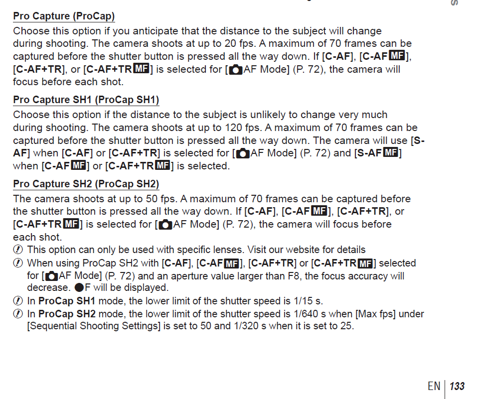

                  But ....... this is what the User Manual has.

                    Just thought it might be better to just use ProCapture with the 100-400 lens as it describes focussing on distance changing subjects for each frame.

                  Already read that, it seems that for 'distance to subject' Pro Capture should be fine, but presumably for PRO lenses Pro Capture SH2 best?? Trial and error??

                    Yeah & how many frames you want etc. I just thought it was interesting that standard ProCapture was described that way & it might be more reliable for results with the 100-400 lens. I rarely use ProCapture myself so can only go manuals & advice.

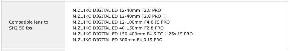

                  Geoff, following lens are supported for sh2 @ 50fps;
                  Click image for larger version  Name:	Screenshot 2023-05-13 at 14.29.16.png Views:	0 Size:	10.4 KB ID:	926302
