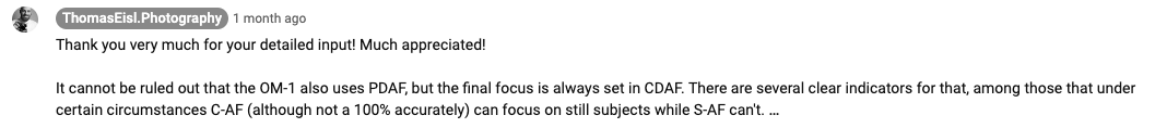

        I also doubt that SAF is only using CDAF (as he asserts). In fact, someone doubted just that in the YT comments and Eisl had to admit that he actually doesn't know:
        Click image for larger version  Name:	image.png Views:	0 Size:	14.6 KB ID:	918067
        Just what are Thomas Eisl's credentials? Does he have inside information? I doubt it.
        Personally, I chalk this video up as yet another "this is what I think it's doing by a reverse engineering thought experiment from the results I'm seeing". If only OM could get one of their techs to write an article that explains what it actually does!!

          Yes, well explained. Just to be clear though, I did ask him a question 3 months ago with his answer as follows.
          Ross the fiddler
          3 months ago
          @ThomasEisl.Photography I was under impression that S-AF used "High-speed imager AF Imager phase detection AF and imager contrast AF used in combination", that is Phase Detect first followed by Contrast Detect. So that is not the case then?
          Reply
          ThomasEisl.Photography ThomasEisl.Photography3 months ago (edited)
          Ross, this is truly a complicated topic and it took a fair amount of testing. Here is what I found out: I am not sure whether the OM-1 uses PDAF first and then CDAF. One thing I'm 100% sure is that the "final" focusing is always done with CDAF in S-AF mode. In order to avoid confusion, I just mentioned CDAF in the video.​
          As part of that "complicated" S-AF process, I do see a few processes happening. If there is enough light it just quickly focusses & takes the shot, if in low light it produces quite an audible 'white noise' as it tries to focus & if it still doesn't lock focus it reverts to black & white, so it is true, "this is truly a complicated topic". And it is true, previous models with FAST DUAL IMAGER AF used PD-AF first but did finish with CD-AF.
