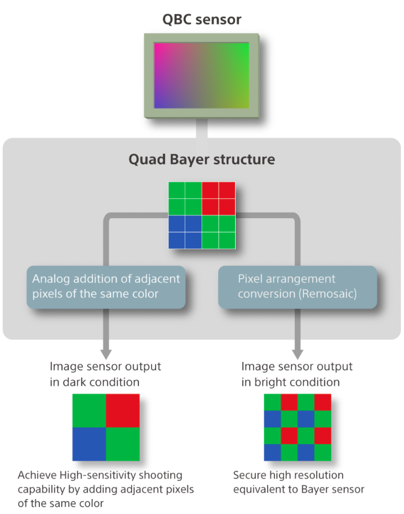

    If I understand correctly, Quad Bayer places four pixels under each of the RGB squares on the CFA. In other words, however big the CFA and headline Mp is, there are actually FOUR times as many actual pixels/photo-diodes. In other words, the sensor is really 80Mp, but it's probably locked at 20Mp output. But why do this? - it seems there are three main reasons (two of which are variations on a theme):
    a) To allow dual resolution shots with different noise levels. This is used in smartphones and is well-described in this article about Quad Bayer Coding (QBC) from Sony (https://www.sony-semicon.co.jp/e/pro...er_coding.html). It allows driving the sensor in two modes - a low light mode with a quarter of the resolution, or a regular mode with the higher resolution.
    Click image for larger version  Name:	Untitled.png Views:	0 Size:	307.2 KB ID:	859176
    But this isn't what the OM-1 is doing. There aren't two separate resolution modes (aside from the Hi Res modes which are the old-style pixel-shift and HHHR stack tricks).
    b) To reduce noise in low light
    This is effectively using only the left-hand side of the diagram above. Some call it "pixel binning" and it seems it might have some advantages in low light over a single pixel of four times the area. This seems a bit counter-intuitive, but it does seem that's how it is. I assume that the improvement in higher ISO (and shadow noise at low ISO) is due to this (as well as the back-side illuminated approach). On the other hand, this post over on DPR proposes that actually it's due to rationalisation of Sony fab processes => https://www.dpreview.com/forums/thread/4629800 .

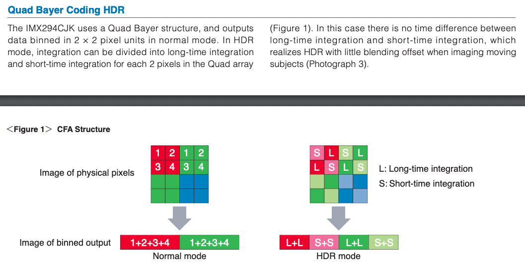

    c) To provide "single shot" HDR
    This is explained quite well in the IMX 294 data-sheet (https://www.sony-semicon.co.jp/produ...4CJK_Flyer.pdf). I'm assuming the IMX472 does the same (potentially):
    Click image for larger version  Name:	Untitled.png Views:	0 Size:	177.4 KB ID:	859175
    But I'm not sure whether this mode is used by the OM-1. It will be interesting to look at the HDR mode on the camera and see whether it's the old-style composite of multiple separate exposures, or this "two images at once" capability of the sensor. Clearly, the on-sensor version would be limited to just two exposures and from what I've read, it seems that 1-1.5 stops of exposure separation is about all you get. From what I can glean, it seems that this HDR capability is really directed at improving movie HDR and has little benefit for stills. I'm confused!
