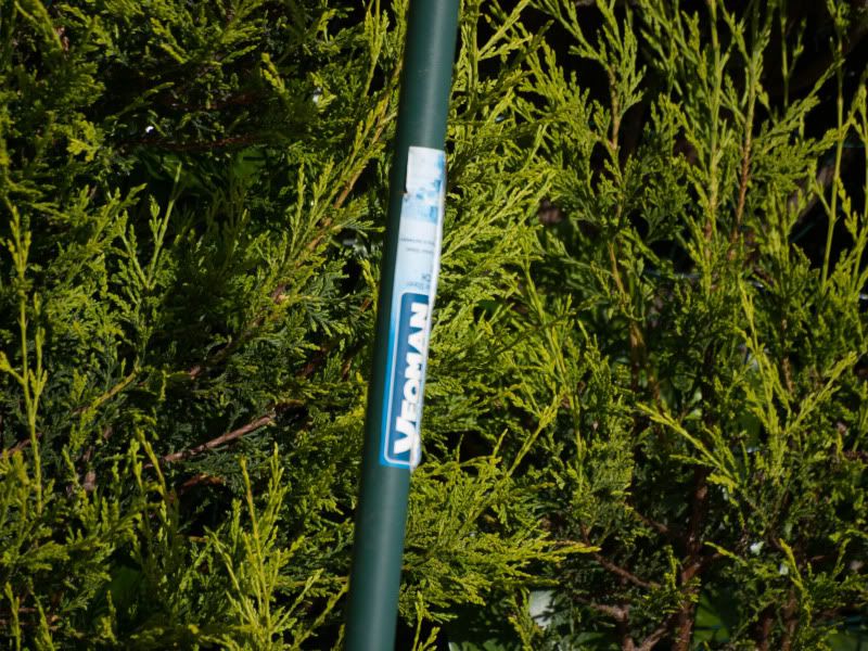

    Below is a picture taken at 300mm on my E3. Ignore the lack of quality, it is purely to put a perspective on the 2nd picture.

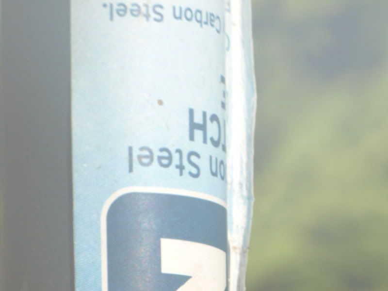

    the 2nd pic is taken with my 1200mm telescope, and with my e410 hand held hovering above the viewer, plus with a 2x adaptor fitted. In affect this makes the telescope 2400mm
    You can see a huge amount of light pollution, this is due to the fact that I am holding the camera above the telescope viewer, with around 10-15cm of 'space' between them.

    Hi Richard,
    The picture is sharp as far as I can see as far as the lower part is concerned, the sticker texture is clearly visible. I suppose you held the camera somewhat titled and not at square angle.
    It lacks some contrast but has no CA as far as I can see. And the bokeh looks OK.
    Trying to figure out - did you mount a EC20 on the camera or on the scope? What lens did you use, if any?

      Re: 1200mm telescope - progress made, more work needed
      Hi Tord
      this is what I used
      Skyatcher Skyliner 200P http://www.telescopehouse.com/acatalog/info_10717.html
      With various attachments onto the viewfinder, to create the longest column I could.
      Then my E-410 hand held (so you will be correct about the angle distortion) above the viewfinder.
      The viewfinder has lenses to sit on the mount, I used it without a lens, and so used the camera and set up below to converge the light onto the sensor:
      E-410
      EX-25
      4/3 mount converter
      2x converter - This was the only 'glass' between the scope and the camera sensor - like this one http://www.ebay.co.uk/itm/KEPCOR-AUT...item2a17211c1f
      In affect, what I did was use the 2x converter as the lens to focus the image onto the sensor. I focused by moving the camera towards, and away from the scope.
      If I get more extension tubes, I can adjust the focus from the viewfinder.
      I hope to get an EC14 soon, and that may be better, with the EX25 and possibly some cheap extension tubes.
