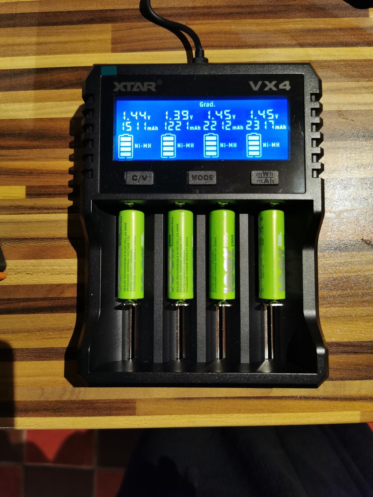

              As the Xtar VX4 can charge/discharge capacity test, I'm putting all my NiMH batteries through it.

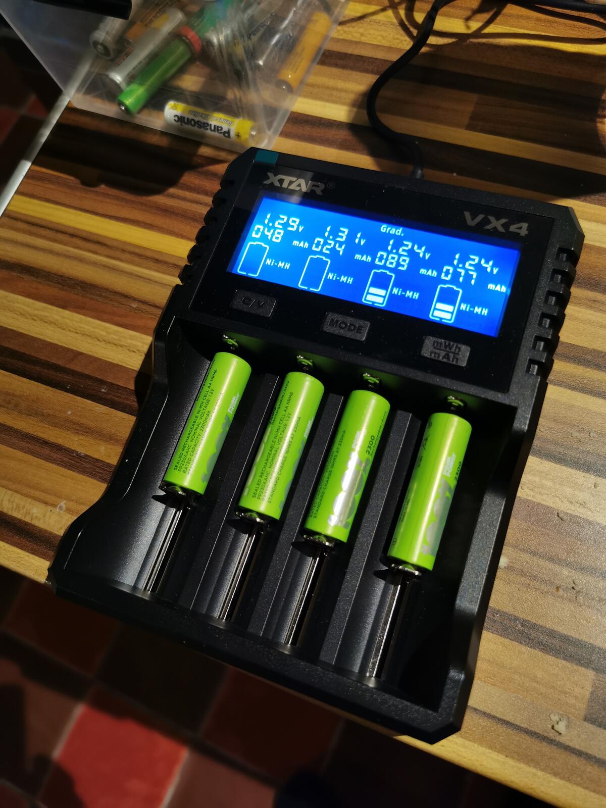

                    These are identical batteries bought at the same time about 2 years ago - labelled 2300mAh.
                    Two conform, but two have below par capacity, probably because they were left in a fly-scaring fan at the end of the summer and not recharged, so sat discharged for too long. They're still usable but will go into a box for less than good batteries.
