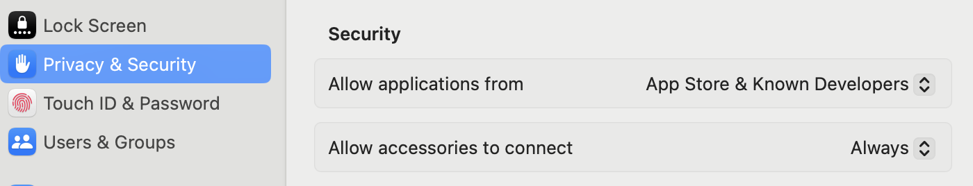

    First up I would suggest to go into the Mac System settings from Apple Menu and have a look at the Privacy and Security settings - what do you see here for these settings:

    I changed the Allow applications from App Store to also include Known Developers when I previously installed OM System to let it install the driver but I had to do something in a pre-boot menu first to lower the security paranoia level of MacOs.
    I also changed the Allow accessories to connect to "Always" so that it doesn't keep asking me to allow the camera to connect over USB.
    If you don't have the above settings I would suggest to cautiously apply them, reboot the Mac and re-install OM Workspace and see if it fixed the issue.

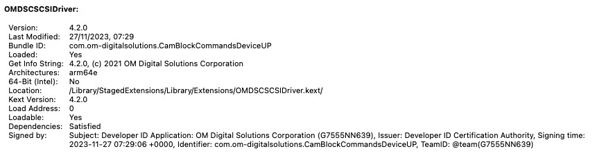

            I'm sure OM could find a better way that doesn't need a potentially risky kernel extension to be installed in MacOS in order to communicate to the camera over USB to update a firmware package.
            This is the kernel level system file they install:
            Click image for larger version  Name:	OM-Kext-file-details.jpg Views:	0 Size:	41.8 KB ID:	1007141
            Apple on their developer site say this
            "Kexts are no longer recommended for macOS. Kexts risk the integrity and reliability of the operating system. Users should prefer solutions that don’t require extending the kernel and use system extensions instead."
            I bet their kernel driver is a legacy method they haven't updated for the latest MacOS + hardware for some reason, I haven't heard of similar issues on Windows 11.
