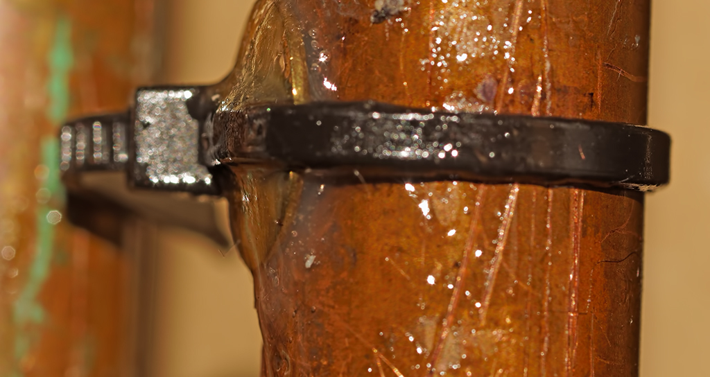

                    Another pinhole leak struck at around midnight a couple of nights ago. To cut quite a long story shor*t:
                    All the following was with the mains turned off
                    I had hoped to block the hole with a tiny brass screw with epoxy cement on its thread. However, with the hole 180degrees away from me, maneuvering a tiny screw into the hole and then using a screwdriver left handed while reaching into the hot water tank cupboard was not going to work.
                    Looking around at the variety of metal bits I had, some drawing pins flaunted themselves. One fitted the leak hole hole fairly well. A new plan formed.
                    I roughed up the shaft of a drawing pin with abrasive. Then I soldered a deliberately ragged piece of solder to its tip, while keeping it narrow. This was to make it less likely to slip out of set glue.
                    I then covered the shaft with fast setting epoxy, eased it into the hole and held it while the glue partially set. I then filled the space between the pin head and the pipe with more epoxy, eased the pin in until flush and tied a cable clip around pin and pipe to hold it in place, as it remains.
                    I then turned the water on briefly to see if there was a seal and then turned it off for a couple of hours to let the glue harden more.
                    Job done but I have asked a plumber to replace the section of pipe with the two pinhole-prone ends.
                    The rather poor photo shows the finished repair.
                    * This was the final repair, omitting the details of the temporary one.
                    Harold
