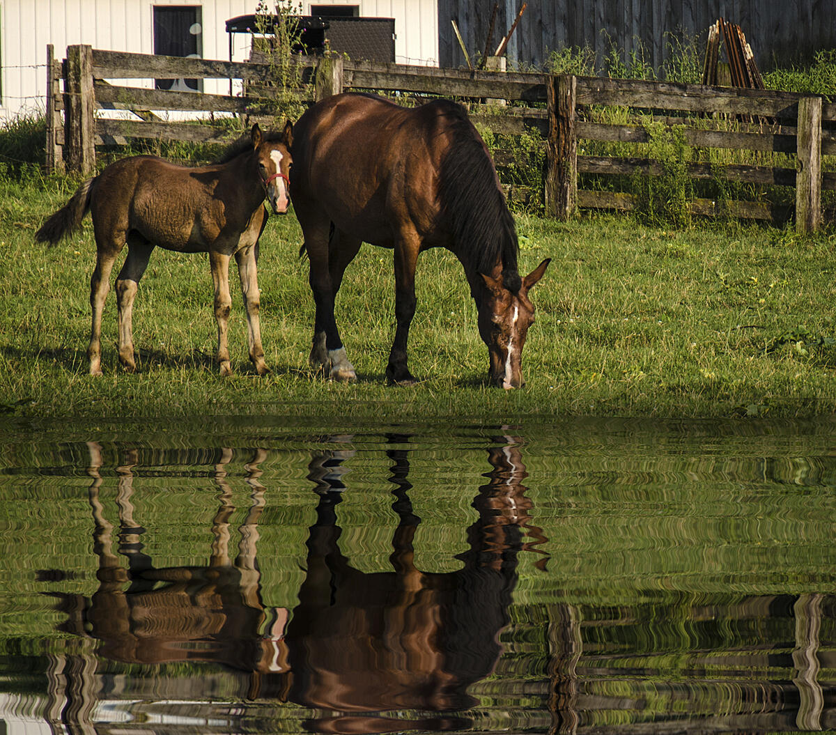

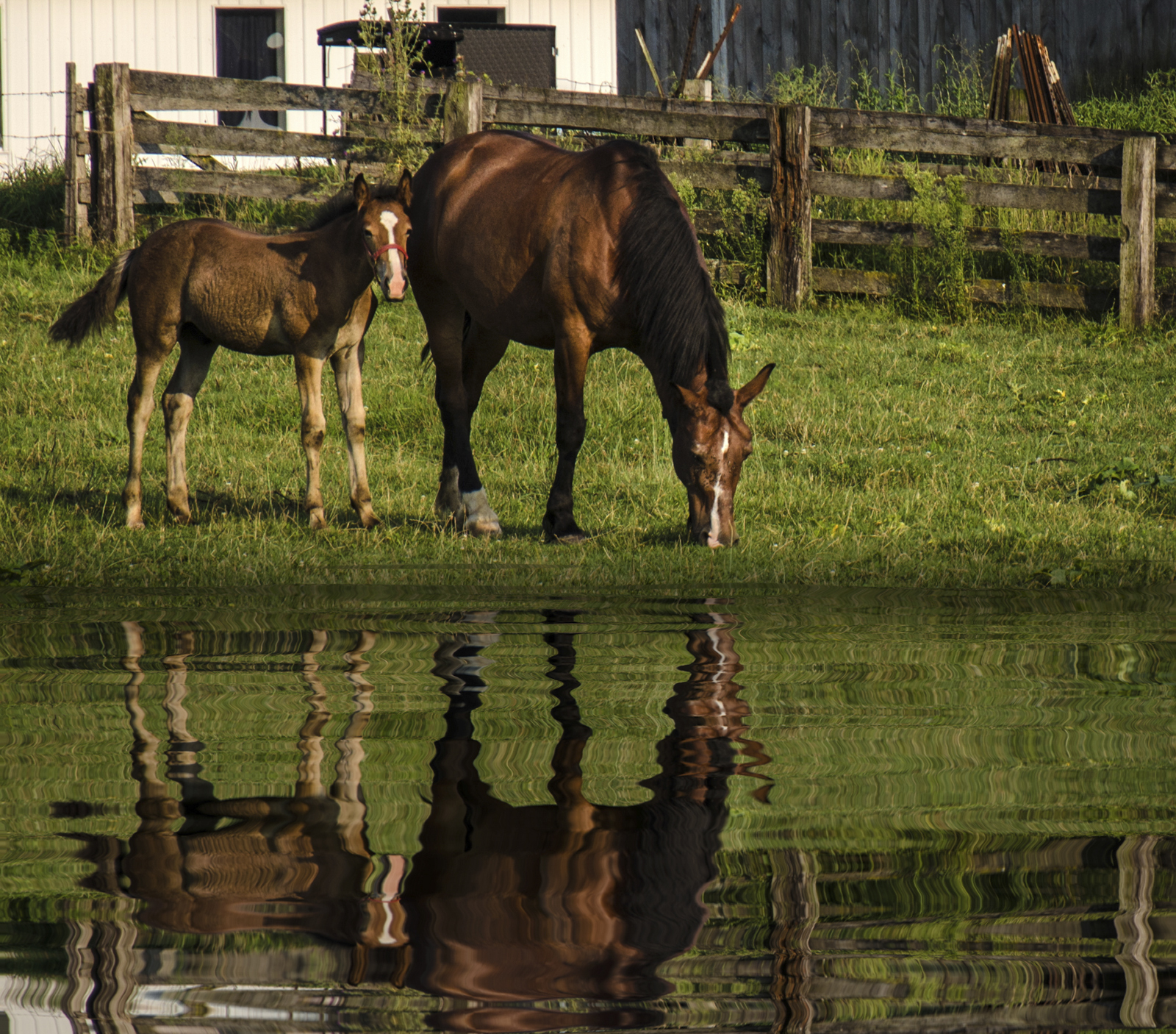

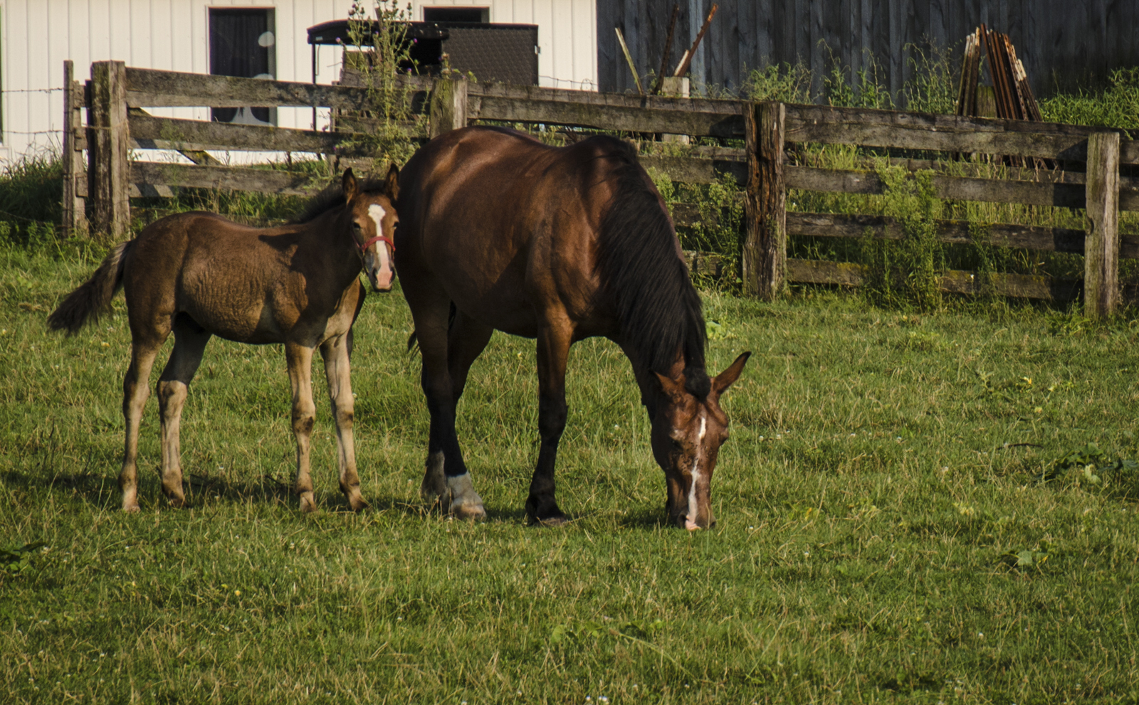

    I used this video to create the transformation that you see below. Below you will find a document of the detailed transcript of the video which contains step-by-step directions as well as all of the settings. I created this document hoping that it would be helpful for those who tried this technique. The first time you go through the process, it takes about 15 minutes because you need to create a DISPLACEMENT MAP that you create only once and can use over on any and all images you would like to try this effect on in the future. The purpose of this thread is to share this technique, I am hoping that you don't mind that I did not shoot my example photo with an Olympus Camera. I took this photo several years ago BEFORE I joined the Olympus team.
    I hope you give it a try and please add your images below this initial post.
    Enjoy, LORELL
Name:	horse reflection, 1-2.jpg
Name:	horse reflection, 2-2.jpg

    Time for a “Turing test” for imagery...
    Graham
    • Luv2shoot
      Luv2shoot commented
      If I can do it, you can all do it. I hope you try this but don't get your feet wet!
    • Graham_of_Rainham
      Graham_of_Rainham commented
      When I judge photography competitions I have that thought at the back of my mind “if it looks to good to be true...”
      Having created composite images on slide film, I also tend to give credit for creativity.
      As long as there is originality throughout the picture and elements are not “bought in”, manipulated pixels are fine by me.
      As long as it’s never passed off as natural history/wildlife...
    I think you are to be applauded for the time and effort that you have put into creating this shot. You have turned what was a rather mundane snap into a very nice photograph. I like it a lot. Well done.
    Regards, Ian W.
    • Luv2shoot
      Luv2shoot commented
      Thank you very much. I first showed my husband picture number 1, he had no reaction and just looked at the two horses. But when I showed him photo #2, he lit up and said, “oh, wow!”. That’s the reaction that I strive for with all of my photos. I appreciate your comments regarding transforming the image from a mundane to a nice photograph. Many thanks, W.
