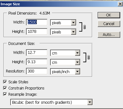

              DPI is another misunderstood thing. As I understand it, the DPI is held as numbers in the JPEG (X and Y dimensions, usually these are the same) and relates to print size, it doesn't affect the computer screen display. Computer screens have a fixed PPI ("Pixels Per Inch") .
              This attempt to clarify this will probably make it less clear: In the Photoshop image sizing dialog it has two sections "Pixel Dimensions" and "Document Size". "Pixel Dimensions" is the actual size of the image in pixels and "Document Size" relates to how it would be printed . The DPI is in the "Document Size" bit, and if you change the DPI Photoshop will respond by changing the Pixel Dimensions so that the printed document size doesn't change.
