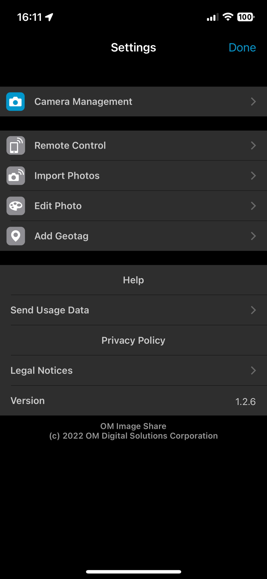

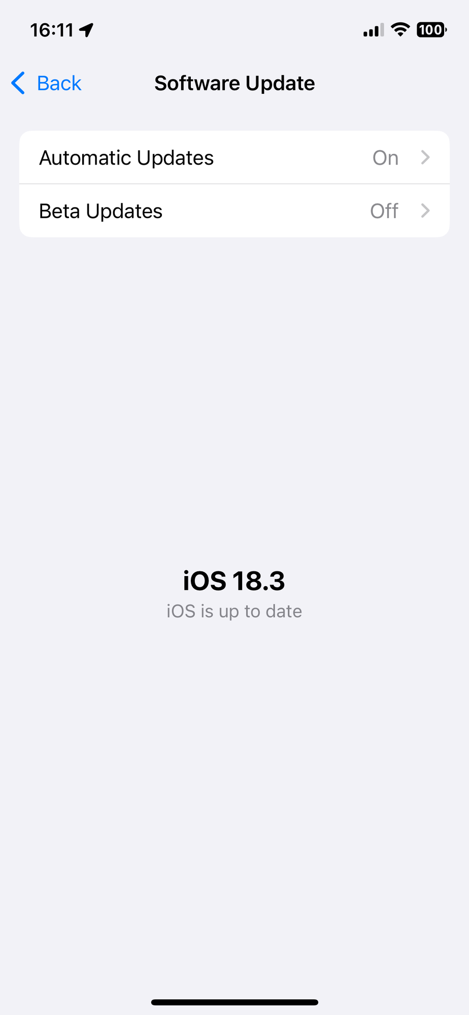

          Thank you Gigirÿche. Have your tried this recently? What version of IOS software are you on - I was wondering whether based on MJ224's comments whether a later version of IOS software may have messed up the access to RAW files?
            These are the version of OIShare and iOS. I don’t have the camera with me, as I am at work, but I’ll try later on and see all the procedures, and see if I can still process ORF on iPhone OIShare.
            OM-1, FL700wr, 7-14 ƒ2.8 Pro, 12-40 ƒ2.8 Pro, 40-150ƒ2.8 Pro, 90 ƒ3.5 Pro, MC14 & MC20.

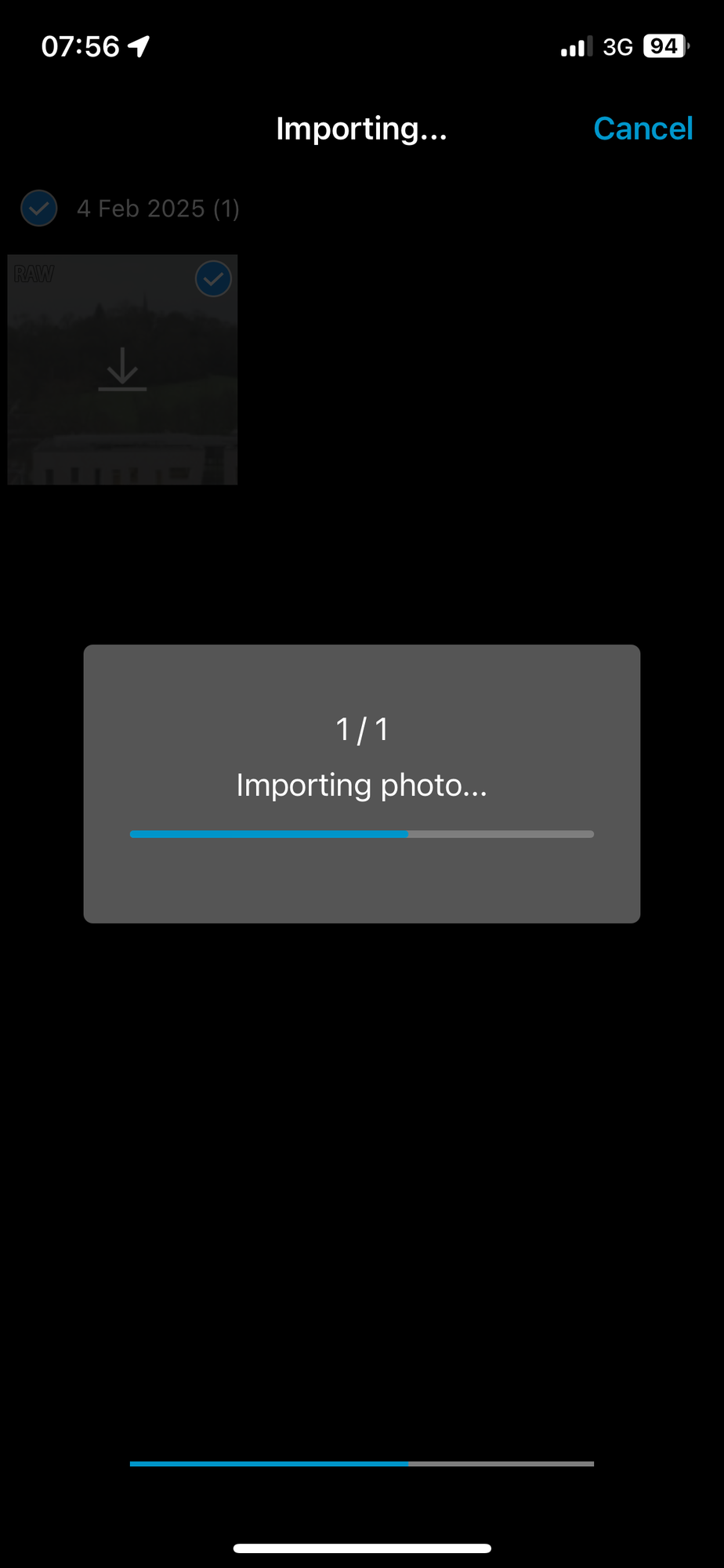

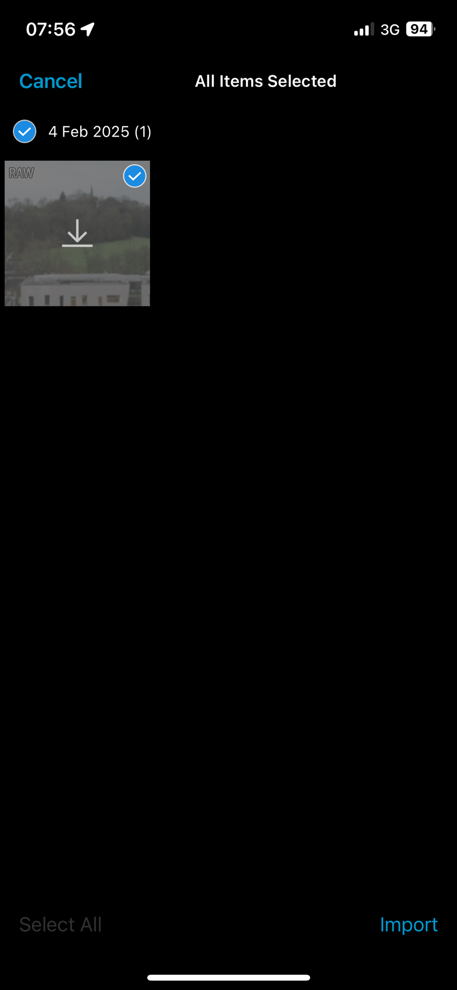

              Good morning
              I apologise for the delays.
              I have tested the procedures for importing RAW/ORF files via O.I. Share app version 1.2.6 on iOS 18.3, and it works fine. Whatever is on the card file wise, gets imported. I have taken couple of screenshots to prove it.

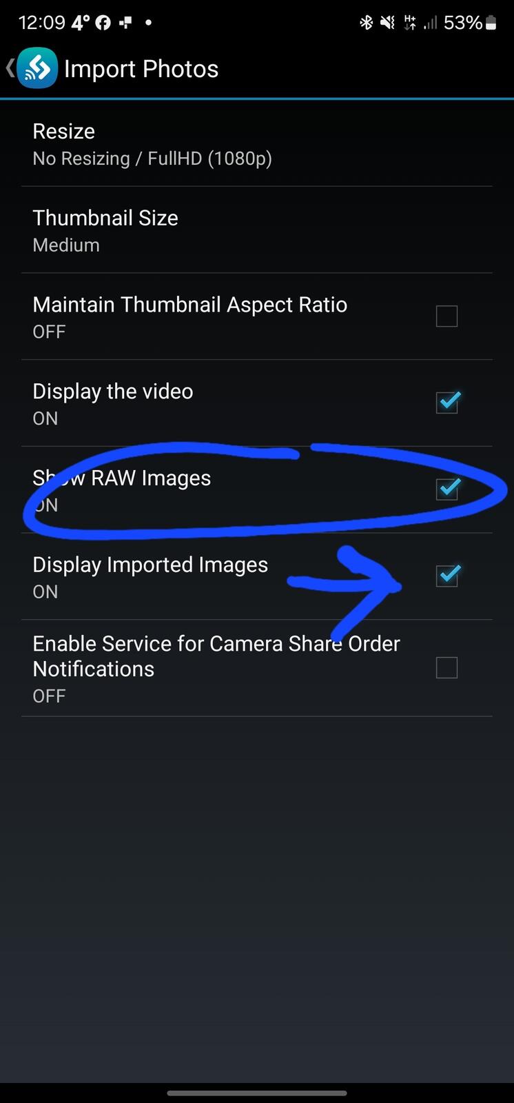

                  I looked at the OI Share app. It definitely can find RAW files on your camera and import then to your phone or tablet, and display thumbnails within the app.
                  There are some OI Share settings you might want to check.
Name:	Screenshot_20250205_120935_OM Image Share.jpg
ID:	1008687 Once the files have been imported, you might not be able to view them in your phone's gallery/photos app, but they should be visible and ready to edit in a separate app, like Lightroom Mobile.
                    I can see thumbnails of ORF files imported and the OI Share editor can edit these files, too. Interestingly, the ORF file doesn't have a thumbnail preview, only a JPEG that is created once you start editing the ORF. It's very confusing.

                      Thanks Ian, yes I've checked these settings. Your post seem to indicate you can view RAW images before importing - I can't even see them.
