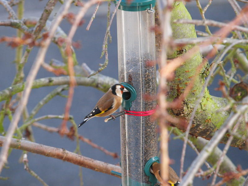

          Here's an ISO1000 example using the EC-20 and 50-200 SWD. Lighting was less than ideal in this case and I find that the combination will quite comfortably stand a wide open aperture (which helps).
          Here's another at ISO1600, again wide open.

              Re: EC20 + 50-200mmSWD breaking all the rules
              So have you tried controlled tests using a tripod and taking your protective filter off?
              It's the image that's important, not the tools used to make it.
              David M's Photoblog
                Yes Dave I have tried this and changed the UV filter for a Marumi Digital High Grade filter. Are your shots taken with a filter?

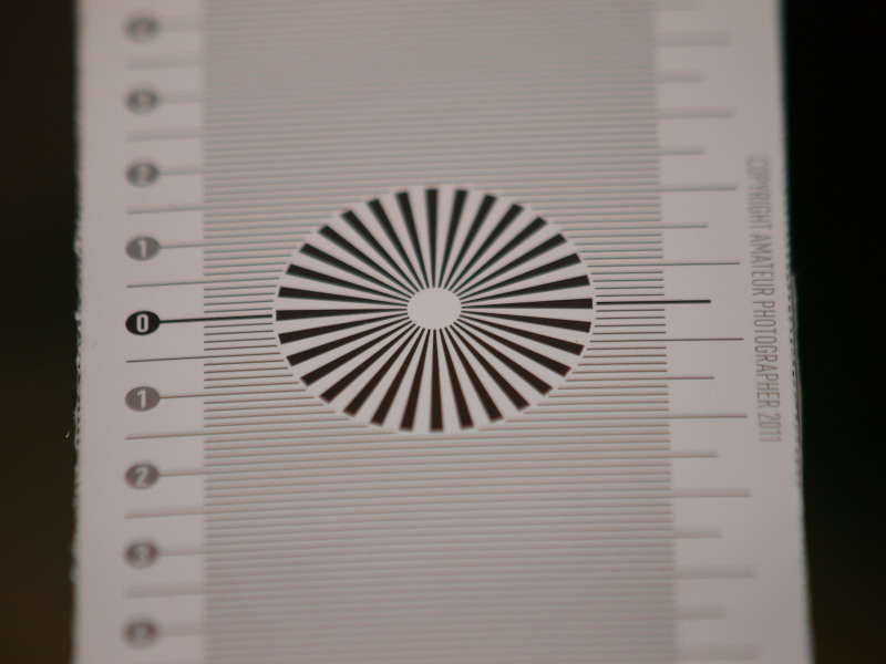

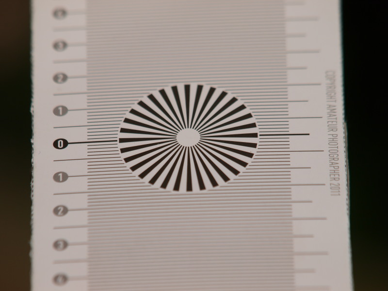

                        Greytop I've done the control tests without either telecoverter and AF is spot on but the image is very soft and only sharpens up when I stop down to say f5.6.
                        The first was taken wide open at f3.5 no crop

                        The second was taken at f5.6 no crop and although there is a change of depth in field there is also and increase in sharpness.

                        Nick I do not think in my case this is a teleconverter problem because of the problems with the lens on its own. I note your own experience of this lens and others that post on this forum.
                        I thank you all your replies and as Nick has pointed out I've written on this before. I am really trying to find a work around and share with others my experiences. I did take all my equipment to my local camera repair man who used to work for Olympus before setting himself up in business. He cleaned all the lenses contacts and sensor. But the problem still exists and the only conclusion is if this is normal then I have a rough lens that should not have got through quality control but Olympus repair do not think it is a quality issue.
                        I do think this is a quality issue and that others like me eventually give up.

                          I'm not an expert on these charts, and it's difficult to be sure on such small images. But I do wonder if you are getting some front focus on the lens/camera. On both charts the first full width line in front of the 0 line appears sharper than the corresponding line behind the 0 line. This strikes me as odd because dof should extend further backwards than it does forewards.
                          Though the test set-up would need to be repeated a number of times to be sure that it's not a minor alignment problem in testing.
                          In fact having written this I note that the target is not central - and in both cases the actual focus point appears to be on the bottom (SSSE) of the taget circle - and on the F3.5 chart that appears to be the sharpest point.
                          I wonder - but mostly if someone with more experience of using these charts can comment.

                              I agree with Nick I think if anything there seems to a tenancy to front focus in these two images.
                              My guess also that this test was performed relatively closely to the minimum focus distance. Have you done any tests with several metres between your lens and the target. The target could be something else contrasty that enables you gauge whether you have any front or back focus at distance.
