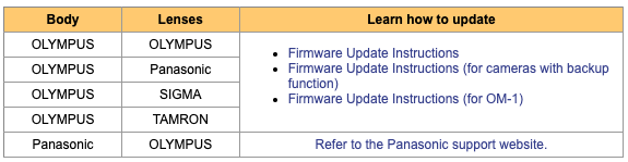

    Does anyone know if this is possible? I have a first-gen Panasonic/Leica* 25 f/1.4 and was wondering if it was possible to even check for updates without a Panasonic body.

    Yes, Olympus and Panasonic have a joint update service. You can find it here:
    Service & Support information page for mirrorless cameras by OM Digital Solutions. Find firmware updates for interchangeable-lens cameras and lenses.

      Paul,
      Many thanks! I'll go play.,
      Steve
