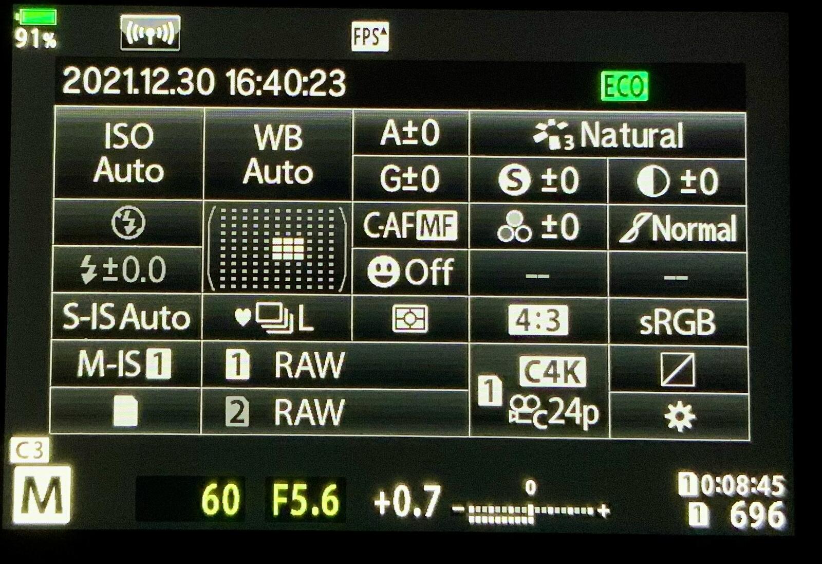

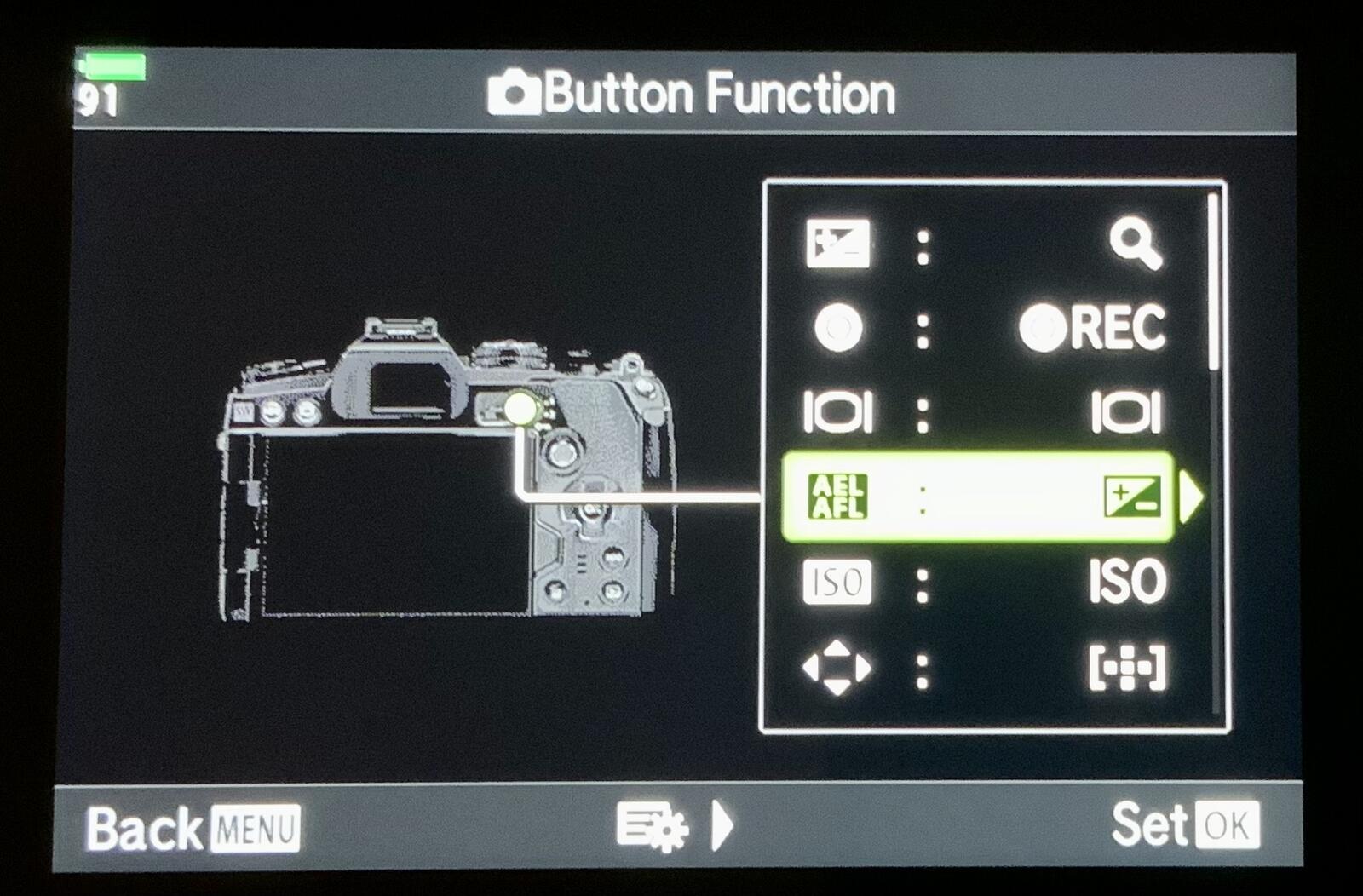

                    I think I confused things with my use of the AEL button. I don’t use exposure lock, I just use that button to assign to exposure compensation in this M-mode Auto-ISO setup. I press and hold the button and turn a dial to add +/- exposure compensation according to needs. I use the front dial for this but either works for me.
                    I find this useful for bird flight photos or for fast moving wildlife. I set the shutter speed and aperture (often stopped down a bit) then select exposure comp according to if there is sky background or trees etc using the live view as well to get it right. I just personally had better success with this recently with my upper ISO at 3200 and trying to make sure my shutter speed is high enough to capture moving birds etc. The high ISO that can be chosen by the camera doesn’t bother me as the software like DXO can sort this out to my satisfaction. The setup means the camera should use the best possible ISO (i.e. lowest) for the given shutter / aperture and light conditions.
                    The SCP and button setup below shows most of the setup. In this SCP I have dialled in exposure comp +0.7 so that is displayed but the meter bars shows lots of under exposure as this is looking at my lens cap in a dark room! This +0.7 is also displayed in the EVF so I always know if I have compensation applied. In menu E1 I set my ISO-Auto-Set for a max ISO of 3200 as the upper limit.
                    I could have used the ISO button instead of AEL for my exposure comp, but sometimes I do want to quickly take control of the ISO and I have muscle memory for that button from assigning it in other setups. You can use any button you like of course (apart from some like bin or menu!).
                    Update : you also need to enable Auto-ISO for manual mode under gear menu E1. Set Auto-ISO to “All”. So much setup with OMD stuff…
