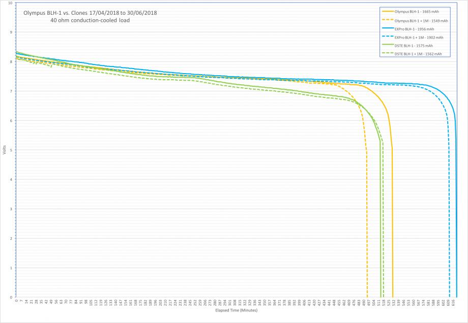

                              Thanks James for the hard work and detailed report. I will be interested to see your results on self-discharge and so on once enough time has passed for analysis.
                              Now we are one month on or more I have re-tested the EXpro and the DSTE which have just been sat on the shelf since the initial test after a full charge.
                              The attached graph is quite small (not sure why yet) but to summarise, the DSTE performed very well in terms of loss dropping only 13mAh from 1575mAh (0.8%). More disturbing is that there is still the kink just over half way through the discharge curve and several more have appeared in the very early stages.
                              The EXpro performed quite well also, dropping 54mAh from 1956mAh (2.7%) however still produced a textbook discharge curve and turned in a respectable 1902mAh capacity.
                              N.B. these are raw capacities, to equate them to manufacturer figures (0.1C discharge rate) multiply by 1.1 which will be very close.
                              The Olympus pack had to remain in use in the camera but will now sit on a shelf for a month when it will be tested as well and the result published here.
                              In summary, from the results so far, the EXpro is holding up very well and should it ever become fully decoded would be a real bargain. The DSTE, on the other hand, exhibits a far lower capacity (although not much less than the Olympus) but the kinks in the discharge curve are of concern so albeit on the basis of a single sample given the very comparable (low) costs of them both in my view there can not really be any justification for buying this over the EXpro.

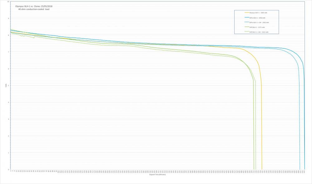

                                Re: BLH-1 Clone Tests
                                The Olympus BLH-1 has just completed it's self-discharge test and in four weeks has dropped in capacity from 1665mAh to 1549mAh - a drop of 7%. This is quite a bit higher than I would have expected from a pack of this quality and price and is worse than either the EXpro or the DSTE. This certainly confirms the EXpro as the standout pack based on the samples I have. Please note - individual packs will vary in capacity and self-discharge characteristics so your own results may be slightly different or a lot different depending usually on the quality control processes employed by the respective manufacturer.
                                Attached the final discharge curves of all three. The '+1M' indicates the second test after four elapsed weeks. A higher-quality version of the graph can be found here http://www.attfield.co.uk/gallery/im...clonetests.png
