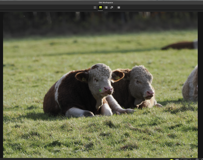

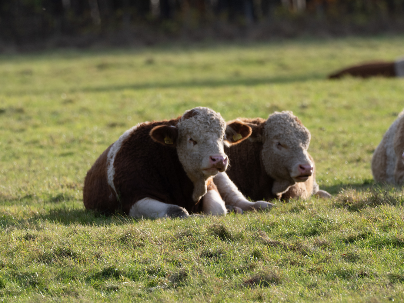

    On a walk in the woods this am, the cows in nearby field looked cute so quick snap but when I got home and looked - out of focus!! Was set up for static birds using single point focus and AF-S. Focus point on pic as shown in OM Workspace. Tracking was set to 'birds' but that shouldn't make any difference, I'd just taken some pics of a Roe deer on the same settings and they were fine.
    Click image for larger version  Name:	OM301156.jpg Views:	0 Size:	1.11 MB ID:	950883

    i'm looking at this on my computer (not my phone) now and I see the grass well in front of the cow appears to be in good focus.
    there is a green box on the cow's face which I assume indicates that the camera's AF sytem had locked (somewhere).
    i agree there is a fault here in that the camera should not have indicated it locked focus in an area that it clearly did not.
    would the camera do that though had the AF target had something to bite on?
    i guess that doesn't matter much...the camera should not lock, nor indicate a lock, if it hasn't locked where the user directs it to lock.
    it's as though the camera has purposed the AF target point as an AF lamp.
      So we do agree its a problem if focus confirmation is given erroneously.
      Also it looks to me that the AF box is transecting a lighter and darker area.
      I would expect in reasonable light that to be enough of a contrast to allow focus.
        I recall reading somewhere that in OM Workspace the green square which is supposed to show AF point isn’t always in the correct place. Ie doesn’t show where actual focus occurred (which seems bonkers to me - why have the feature in the software if it doesn’t show the right location!).

          I've also read that, however the green box shown would have been very close to the actual focus point as seen in the viewfinder which was on the cow's face.
        I can forgive all AF problems, but false confirmation is a deal breaker. I found exactly this within a day of using the OM1 back when it was first launched. Seems it’s still an issue.
