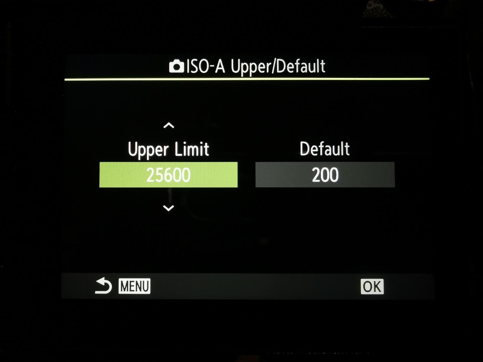

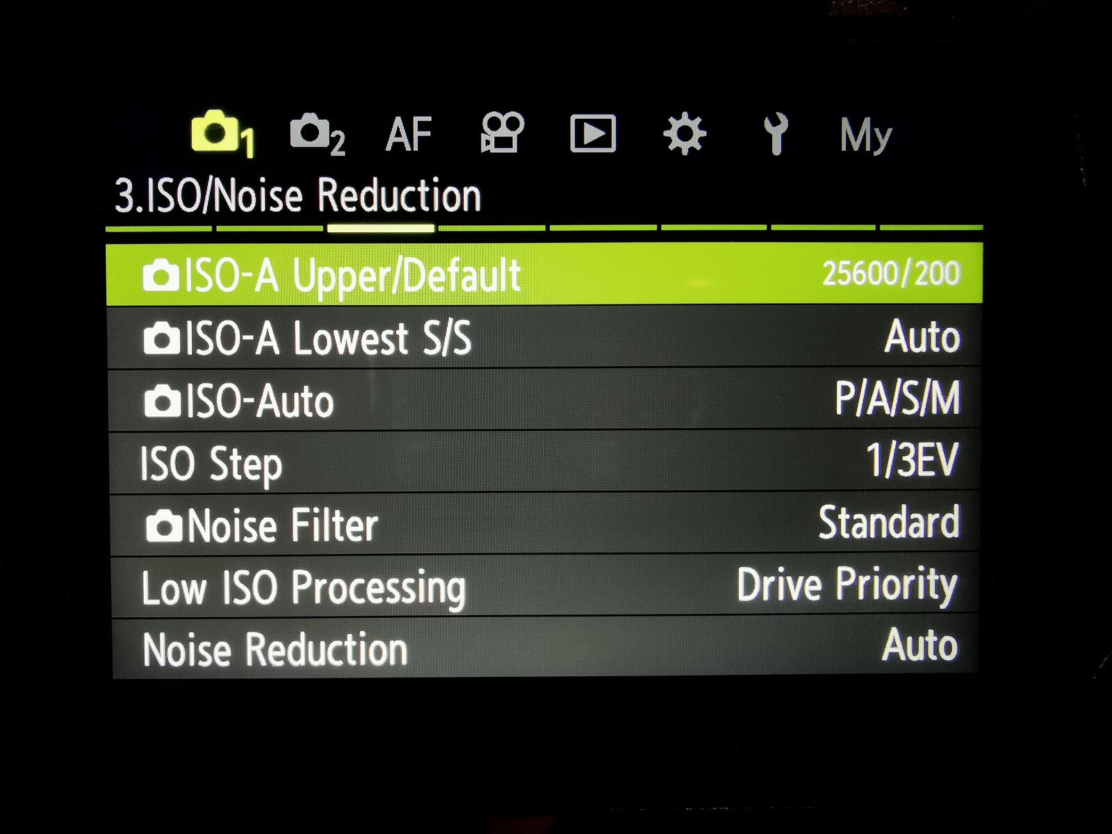

    Hi, new here and hoping for a solution to my problem from one of you.In the menu Section 1 page 3 I should be able to set max upper limit for auto ISO. It will not allow me to set above 800. And yes, I do have the manual & Dax Smith's video.

    It's working for me:

    Are you using silent shutter mode?
      I think the shutter mode affects it maybe. If I have SH2 mode for the shutter the max upper ISO range I can set is 12800. So I set it to silent sequential low and set upper Auto ISO range to 25600 like Ian has, then I set my shutter mode back to SH2. I can’t find anything about these limits in the manual so far.

        Do you have LiveND enabled by any chance? That limits upper ISO to 800 and it will also limit the Auto ISO upper config. Worth a check on Camera 2 menu page 1.
          Aaaaaaaaaaaaah! Yes, been indulging in ICM and left the ND filter on. Many thanks.
            Glad it’s sorted. They ought to have a something in the menus saying why these ranges are restricted, similar to what they have to tell you why menus are greyed out.
