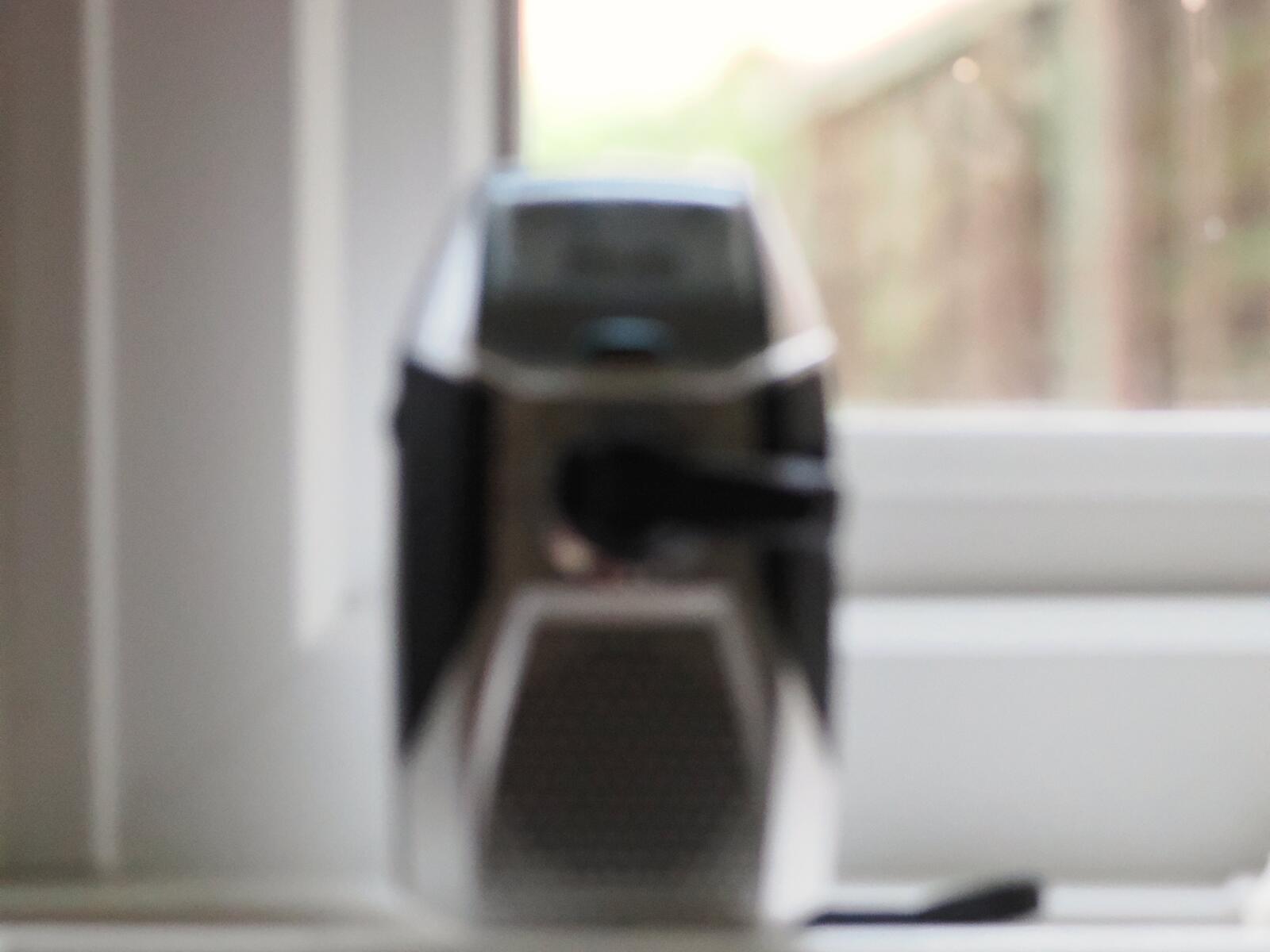

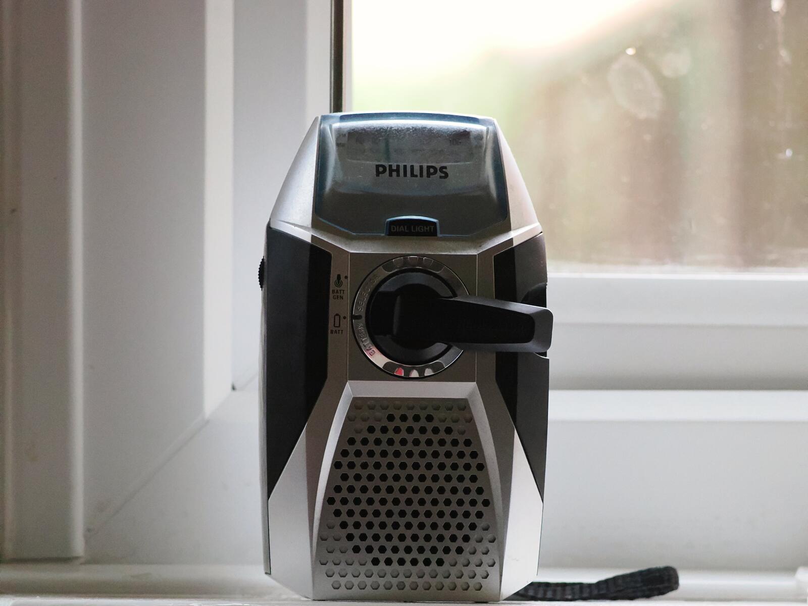

            I tried playing around with S-AF again today with my 100-400 pointing it at a random object on my windowsill and with the new firmware. I can still repeatedly get the AF confirmation with blurred shots using S-AF. It mostly happens with the smallest focus point and it much less likely if you use a cluster of points on the subject.
            The subject is this radio below. You can see it is backlight with the window behind, so not great lighting. If a single AF point is placed on the black winder handle it is low contrast and I will quite often get a blurred shot even though I get a steady green focus confirmation circle. Sometimes the green circle flashes to show it is not focused, but this blurry shot below did have focus confirmation.
            If I use the small cluster of points or the cross points pattern, I will get good focus nearly every time but sometimes it still fails to focus (with focus confirm). It is most reliable if I place the focus points over the speaker grill of the radio. Although I get this focus confirmation / blurred image scenario I don’t seem to get the issue I had before where it gets stuck in a mode and I have to re-power the camera.
            After finding this with my OM-1, I wondered what would my E-M1 Mk3 do with the same subject, same lens and this lighting scenario. So I swapped on my Mk3 and set it to S-AF with the smallest single focus point. The Mk3 got focus confirmation and a well focused image pretty much every time. It didn’t seem to matter where I put the small (but larger then OM-1) focus point on the subject. The few times it didn’t focus the focus confirmation dot flashed to indicate this.
            I’m not trying to bash the OM-1 or anything, it is a fine camera for me. This S-AF thing is just what I have found playing around and it is not a scientific controlled test - I am just sitting in a chair pointing my camera at stuff. It seems to me that the focus behaviour of the OM-1 is different from the other cameras like the Em-1 Mk3 though. I always tended to use the smallest single focus point to get precise focus on a subject but it seems like with the OM-1 it is such a small focus point that this can hit a low contrast area perhaps? I’m thinking it might be better to use a small cluster of points. Perhaps there is some setting I have failed to set or set the wrong way.
            Another odd thing I have noticed with the OM-1 is that sometimes when the focus is hunting, you don’t just get the sound of the lens focus motors but the camera IS mechanism seems to make a whirring noise as it tries to focus. It doesn’t happen every time but it happens a lot if you put the focus point on a low contrast part of the subject, like the black parts of this radio here. Maybe it is trying to jiggle the sensor around to get better focus?
            Focus confirmation and good focus:
            I got focus confirm with this but it is completely blurred:

              When I use the small cluster group I have to aim slightly higher to obtain focus- not have the "object" in the centre , I know someone else who finds that as well, when out last night waiting for the owl, I was playing around using C1 shaped like a letterbox as I did not want the undergrowth to affect the focus . I wondered if the actual focus area is slightly bigger than the set focus box - it seemed that way which would explain my thoughts on the small box. However I did get some good pics even at iso8000 , as DXO has not as yet included the OM1 profile I used OM Workspace AI but found the Affinity Photo did a better job of the noise IMO.
