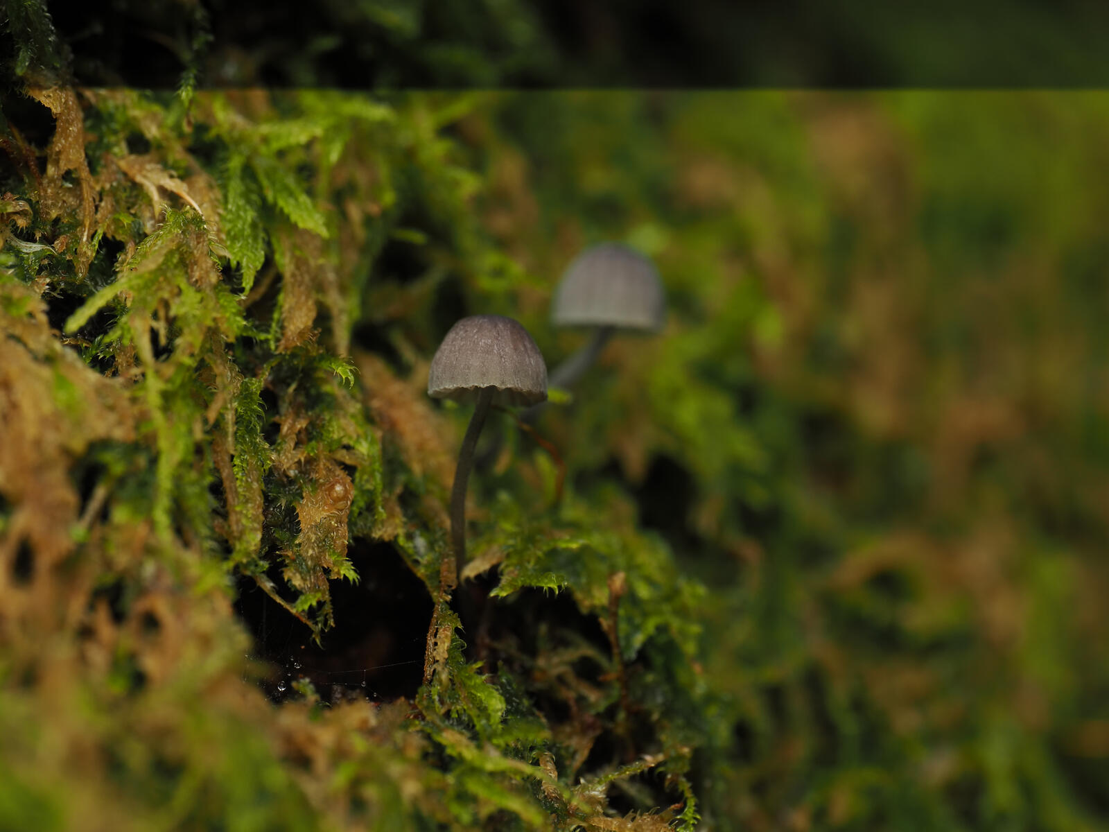

Any idea what's going on here?
  • Any idea what's going on here?
    Focus stacking, F8, 1/100th, manual. Settings saved to C1. Yesterday, I suddenly found that I had a dark bar along the top of the images. Today, I shot a test stack and it was barless. I took the camera out with me, the first two stacks had no bars and the third and subsequent all had bars. The time between the two was seconds! I've no idea what's causing this. Any suggestions will be gratefully received!!
    were you using flash? (It doesn't look like it though). Can you see the exif data on the files? Were the shutter speeds the same? What are your C1 settings?
      Yes, to flash. 1/32, manual. It was flashing away like normal. I have looked and you're correct the shutter speed is not the same. The first stack 1/100 - no bar, second stack 1/125 - no bar, third and all the rest 1/125 with a bar. I must have contorted for the shots and my thumb rolled the shutter speed up. Odd that the second stack was ok? That's probably it. All my gear is packed away at the moment so I'll confirm tomorrow. But in the meantime, thanks very much for the 'point'.

          I had something similar when I was doing some work indoors recently...I had the flash on one of those off camera hotshoe cords and whilst holding the flash rotated 90 degrees (don't ask i was just trying things out) all my images ended up with a top bar....rotating it to a more normal position everything was fine.
          I put it down to some form of bad connection / cheap cable I was using so as I was just messing around left the flash in its more normal position.
          Doesn't really answer your question but just a similar observation.
          Matt
            I think your answer is here re the flash sync speed
            I have taken the plunge and bought an om-1mkll, m.zuiko 90mm f3.5 macro, v860iii flash and cynutech diffuser. The aim is beetle macro photography. So, yesterday i started playing with the features that i was particularly interested in: focus stacking and bracketing and i straight away ran into problems that made no sense to me.
              https://www.e-group.uk.net/forum/for...h-a-new-set-up
              I'm surprised that AI isn't intelligent enough to come up with the obvious and most likely cause. 🙄
