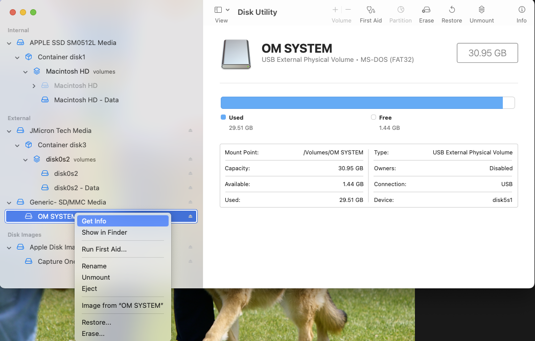

      Hi
      My 2012 Mac mini and 2017 MacBook Pro can both read 32GB UHS II sd cards, so I believe your system should be able to read these cards fine.
      The issue I get is that the card is sometimes not shown in finder once card is inserted. No idea why. However if I start Capture One first and then insert card it always recognises the card. Not sure if that also works with OM Workspace.
      When I've checked this before it seems the card is recognised by the OS but not mounted. When you get this issue you can go to applications/utilities/disk utility. This will show the disks attached to your system.
Name:	Screenshot 2022-06-17 at 08.55.57.png
      You should see something similar to above showing an OM SYSTEM SD/MMC Media with a mount point. If it is not mounted you can right click and use mount ( mine is already mounted and shows unmount option )
      HTH
      Gary
